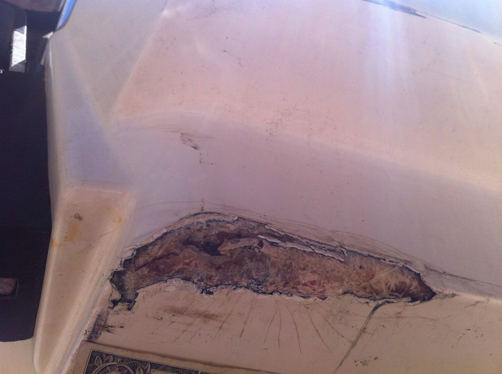

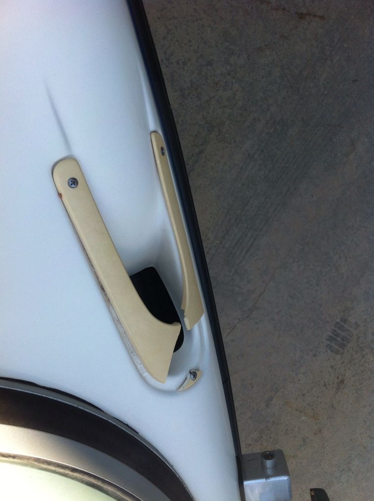

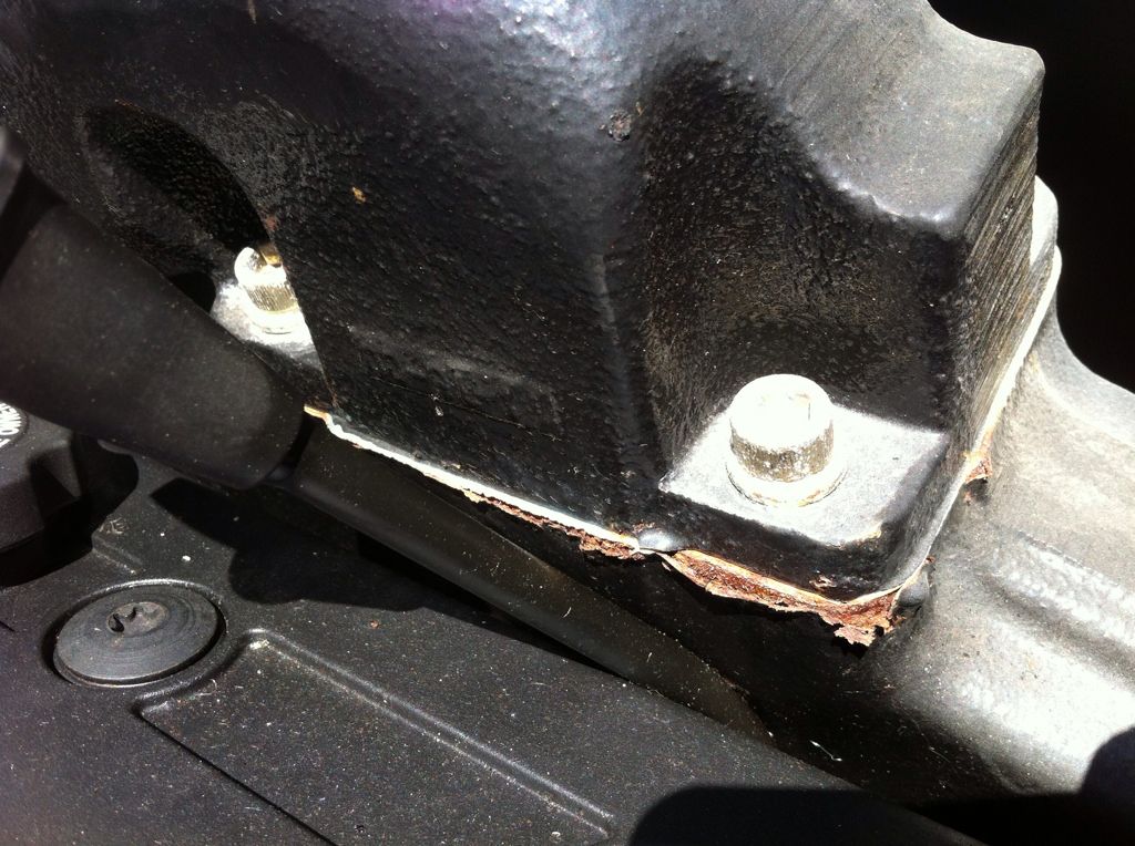

        I was finally able to take a look at the boat today. It looked great from 50' away and probably even 20' away. Upon further inspection, I think I would be wise to let this one go, although it may make a good project boat for someone. It does need a good cleaning, wet sanding and buffing out and that would make a world of difference, but then there is everything else. All service was done through the marina that stores the boat and the mechanic said it runs great, but after looking at the boat, I would have to see to believe. The vinyl was in okay condition and I could live with it through the summer, but I would replace it come winter time. The stickers could all use replacing and the stbd vent cover was broken. There was no ballast or bags present as I suspected. The tower was a Monster tower with two Monster quick release wakeboard racks and it did have speakers, although not nice ones. I did notice there were some spider cracks starting to develop around the tower feet, which probably meant it did not have backing plates. The stereo was a Sony, and looked fine, but I was unable to test it as the battery was dead, therefore I also couldn't get the engine hours. The interior speakers were Clarion and all looked to be busted. There was a little water sitting in the bilge, which I was unsure of bc it was supposed to be in "dry" storage. I don't think it comes with any cover of any sort. The prop was pretty dinged and dented up, which could lead to other possible issues. The front rub rail looks like a beaver got after it and then there is the hull and transom area. I am not sure what happened, but they do use a large fork lift to move the boats up and down and it looks like it could be damage from that. If it were not for the fiberglass damage, I think I could live with everything else, but that in itself shows me that they really do not or have not taken care of this boat.

              I just got an estimate back on the fiberglass work at $3-5k. That boat would almost have to be given away for me to justify, I think. I am still waiting to hear back from the mechanic on total hours.
