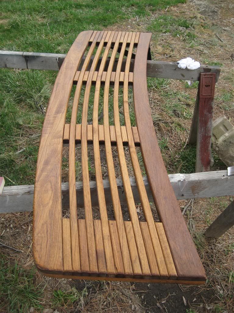

      Here is what I did all day...
      I have my platform sanded and my buddys '03 209 sanded. I had a little help with my little brown friend.
      I am going to use linseed oil and mineral spirits. 80% linseed oil and 20$ spirits. This is what Tommy Nation recommends to use instead of teak oil. Tommy owns Teak World Enterprise. He makes teak platforms for Mastercraft.
      Therefore I will not be using Teak Oil. I will show after pics when it gets oiled.

                            • Sanding complete. I was surprised how much material I needed to sand away to get rid of all the whitened teak. I removed the brackets to complete a different repair, but I agree you wouldn't want to remove/replace screws more often than absolutely necessary.
                              So, my platform is all sanded and ready for the linseed oil mixture. Here's a couple pics of the process...
                              1st pic: Before.
                              2nd pic: 1st sanding. Removed a lot of the white, but the deeper stuff required a lot more work.
                              3rd pic: Finally! Sanded and ready for oil.
                              Kyle,
                              After I apply the linseed oil, then wait an hour and wipe off the excess, can I move the platform, or does it pretty much have to stay where it is (untouched) for a week or so to continue drying?
                              Thanks for your help with this!

                              • Kyle,
                                You can move it but it will be oily and not be dry. I would do the bottom and let it sit for a day or two. Temp is in 60' or 70's now. Dry time is faster. Then I would fix your bracket issue. Last do the top and make your teak look like a fine piece of furniture.
