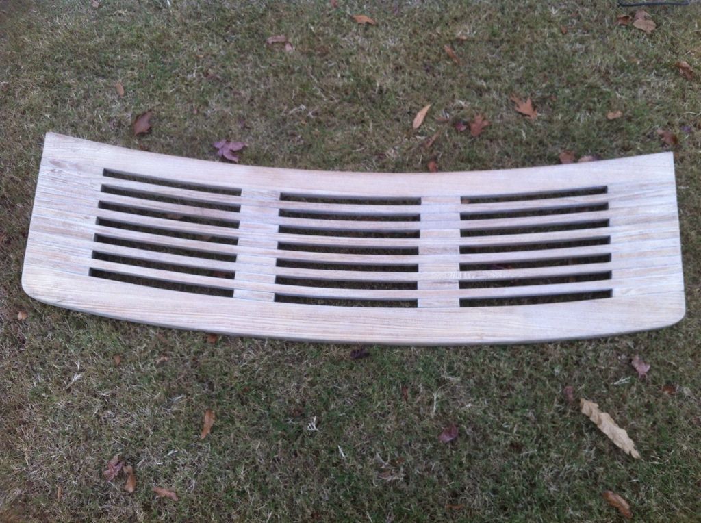

  • Just pulled my teak for some much needed rehab:
    • Using Harolds method, how long do you let it dry between coats before sanding?

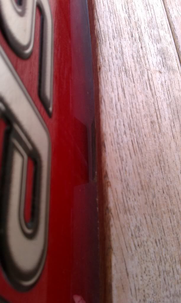

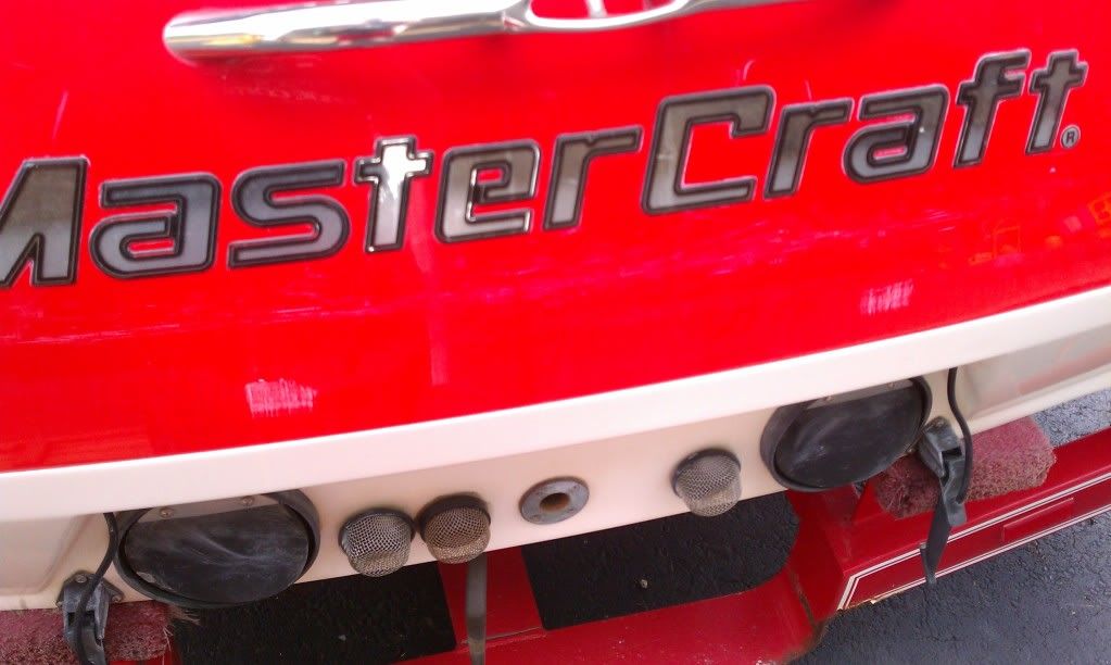

        • Originally posted by jay View Post
          It shouldn't be touching the boat. I know mine touches against the depth sounder feed-line, but it isn't compressing it...?
          You can see here what I am talking about. Whenever someone stands on the platform, it will flex just enough that it rubs.
          And here you can see where it rubs against the boat.
          O1 X-Star
          • 2 options to fix it.
            1 remove platform and sand the side that will face the boat. Make sure that you keep the same arch as the boat.
            2 leaving the platform attached to the boat. Remove all of the screws holding the platform on. Move the platform out 1/2 to 1 inch. Pre drill new holes. Screw the platform back on. Remember do not remove the brackets from the boat.
            The platform has play in it so when you stand on it, it will flex. Also when a wake hits the back of the boat it should flex snd not just snap off. The problem lies on the person at the dealer who installed it too close to the back of the boat.
            I'm sure you can wet sand the back of the boat where the scratches are and buff all of that out.
            Good luck

            • Yeah, I thought about sanding it down some. Maybe I will sand the edge down and move it out a bit. Are there any negatives to unscrewing it and moving the brackets back on the teak more?

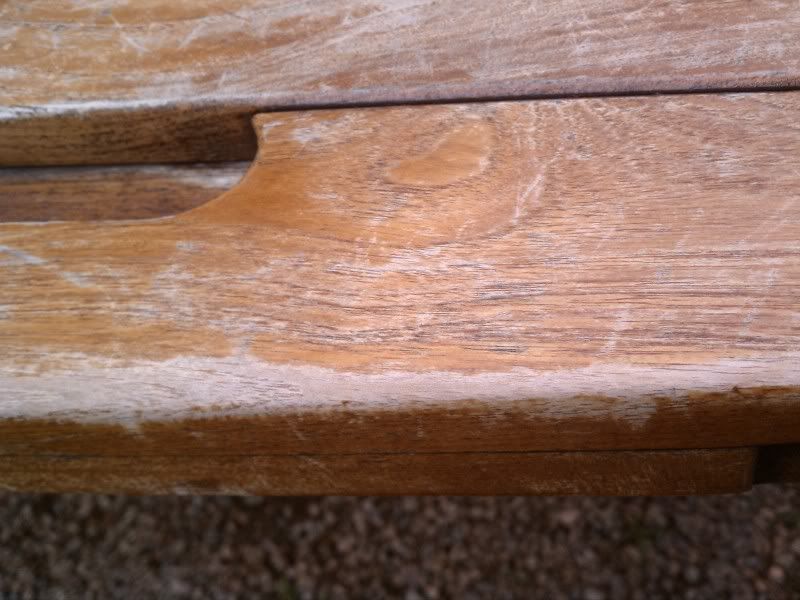

                  • The platform on my old Prostar and the SN I grew up with were always treated to an occasional sanding/oiling and looked good. The platform on my current X2 however, is in dire need of attention.
                    Almost embarrased to post this, but here's a pic:
                    I've been hesitant to proceed because it appears as if it's been sealed as opposed to just oiled. You can see the darker areas which appear finished vs. the lighter unsealed areas.
                    Any specific recommendations on how to proceed given the splotchy finished surface? I'm not looking to make this into a piece of furniture a la TMCN01, but would like to protect it and make it look presentable. Guess I'm looking for a quick and dirty set of cliff notes to get this thing in shape for the rest of the summer with the assumption I'll do more later??
                    Thanks!
                    • Just needs a light sanding and couple coats of Teak oil and you're good for the season
