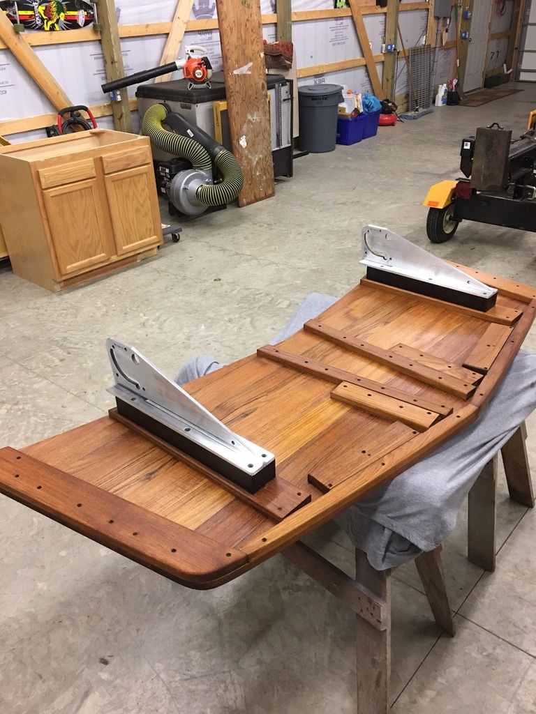

                • Here's my teak update, previous owner had platform varnished and wasn't a fan. Did a little sanding and painting on platform risers. 80/20 mix for me worked great and very easy to work with.
                  [IMG][/IMG]
                  [IMG][/IMG]
                  • 1000x better, nice work rainman.

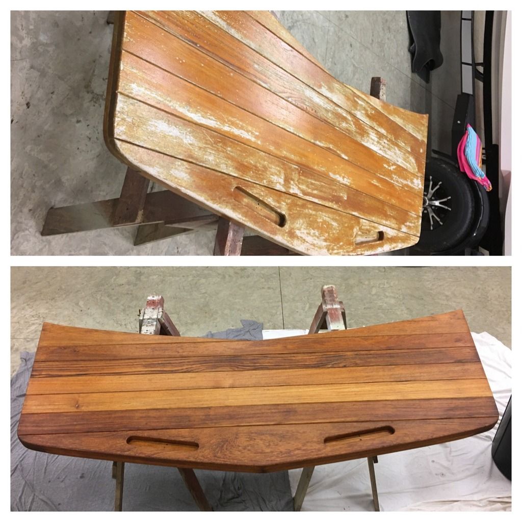

                    • Got her ready for summer
