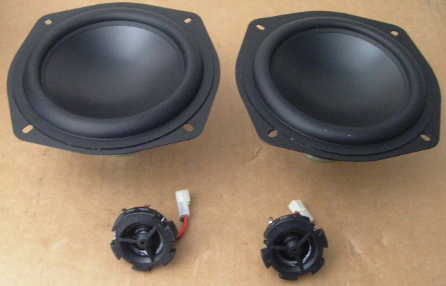

                          Also, why to the companies mean when they say the speakers are a component style coaxial speaker?
                          • #14
                            Component separates the tweeter from the midbass driver whereas a coaxial will have the tweeter in the middle of the midbass driver (generally).
                            Component - Separate tweeter and midbass drivers:
                            Coaxial - "all-in-one" so to speak:
