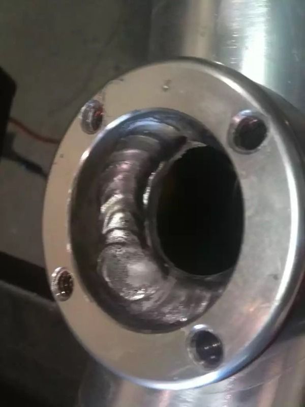

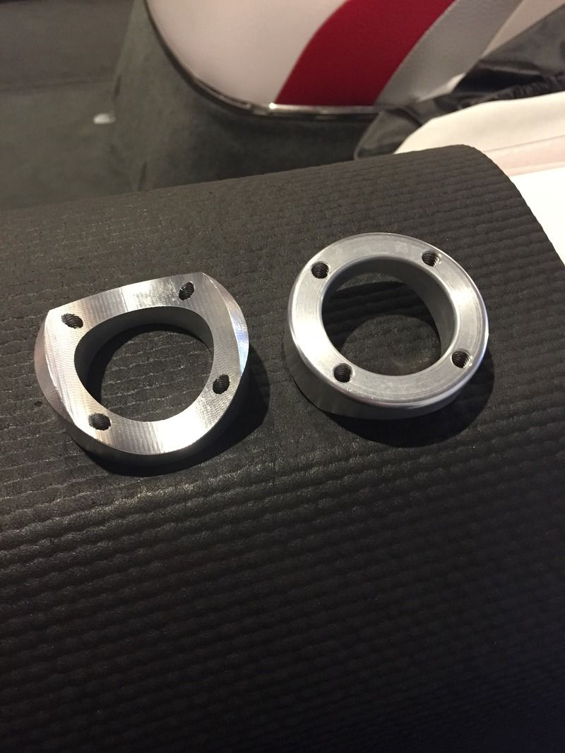

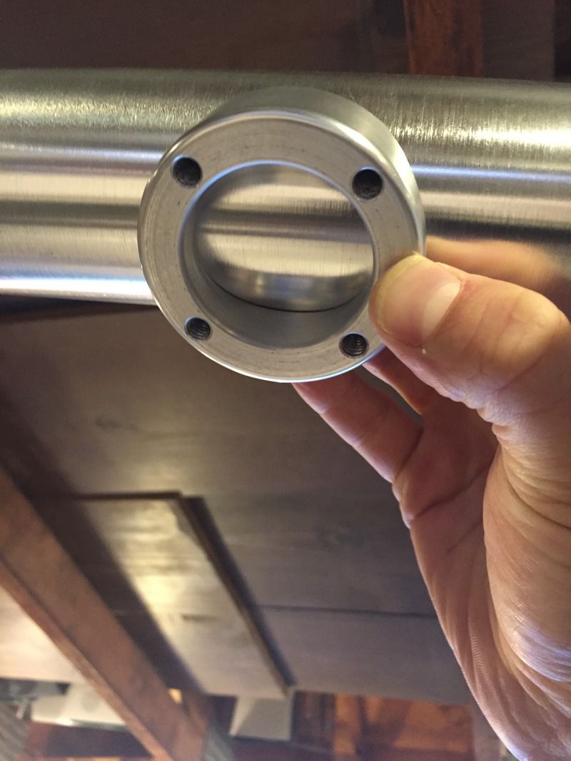

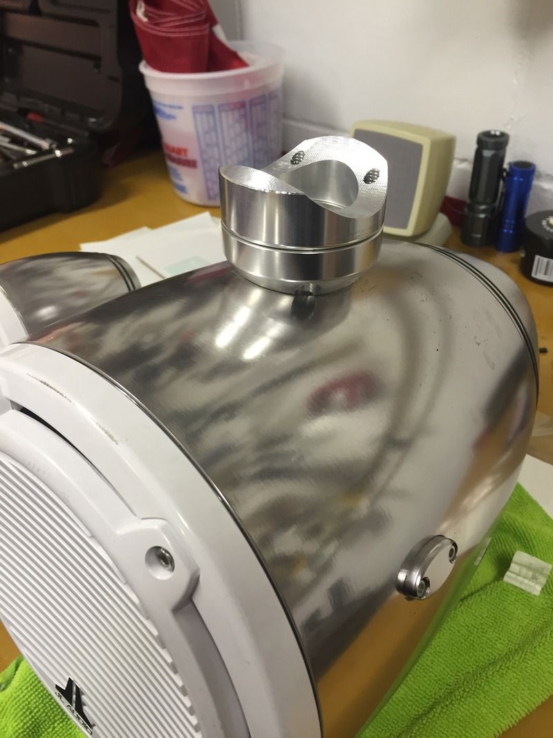

              Figured out my solution.
              I bought a set of the weld on adapters for the 07+ towers.
              In the spring I'll find a welder to weld these mount points to my 06 tower. Drill a hole in the tower after welding. Bolt on and go.
              Here are a few pics of the adapters I bought. They fit my tower diameter perfectly.
              Here is a photo I found online of the weld inside the adapter. That's what I am going for.

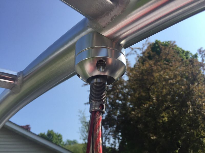

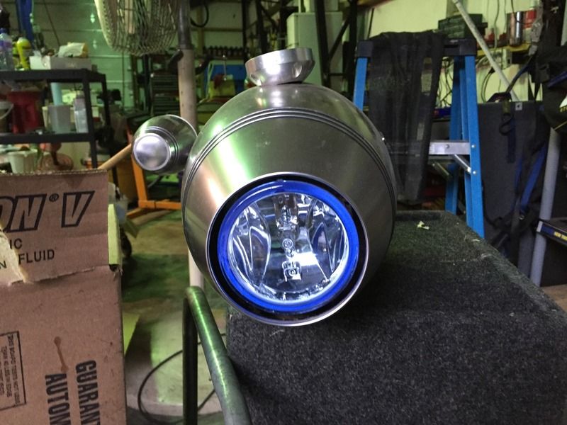

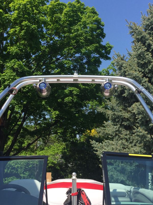

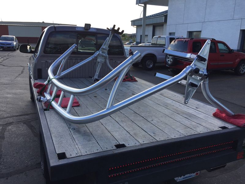

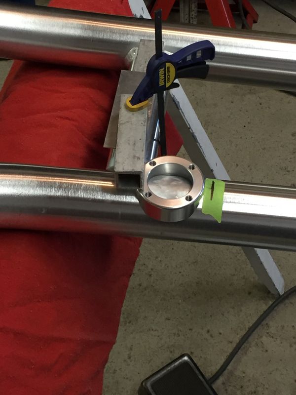

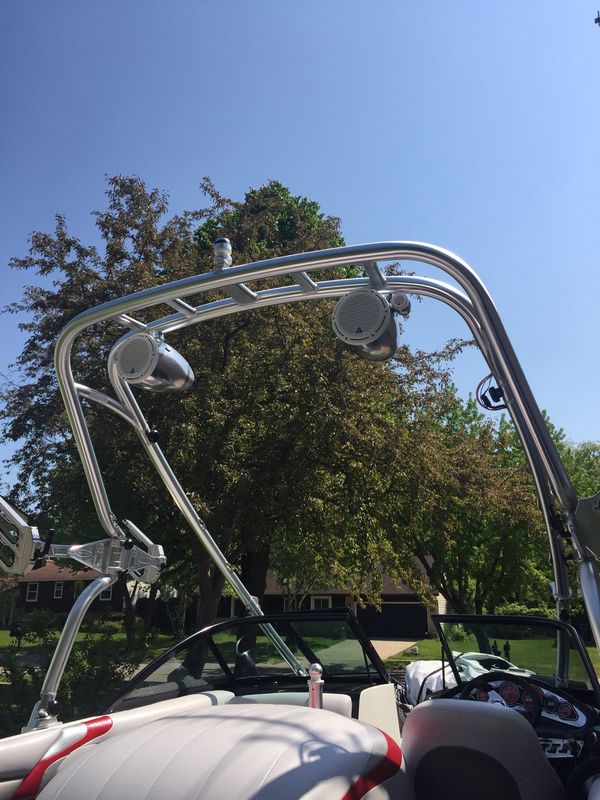

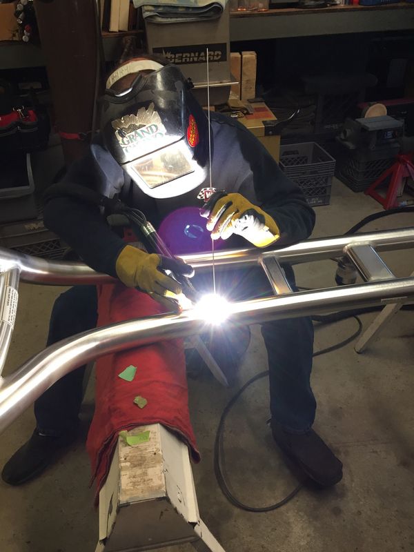

                  Speaker project completed.
                  Had the adapters welded on just like planned. Here are a few photos.
                  Had a good buddy with a flatbed to transport.
                  Sanded down some of the clear annodizing inside the ring for welding prep
                  Just have to complete the plug system, where the tower splits to fold.

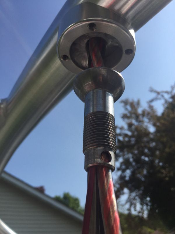

                      Where did you buy the mounting brackets. I have the same speakers as you but they didn't come with the mounting hardware. The tower I have already has the mounting brackets, I just need the part (and screw) that mates the speaker to the bracket on the tower.
                      Attached picture is what I need.

                        Try contacting GereMarie.com
                        That is where I bought the part that weld to the tower. (the mating part) of what you are looking for.
