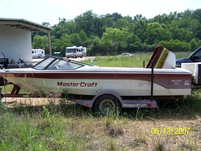

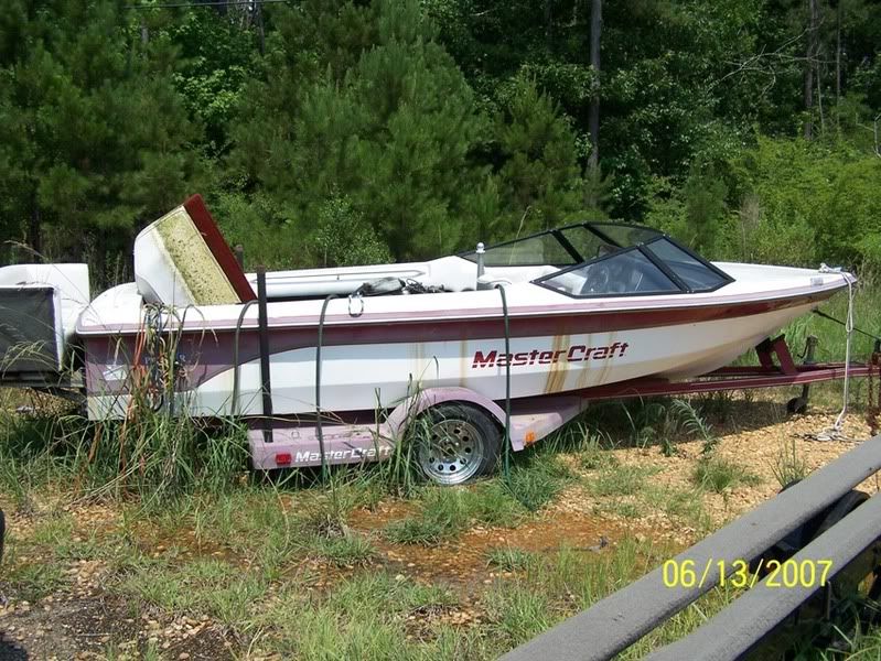

    A little over a year ago I started on a project rebuild. I found this 1989 Prostar with only 350 hours that had been neglected and abused. When the previous owner quit using it they parked it back behind a building and left it there (with the PLUG IN THE BOAT). For 4 years it sat and nothing happened with it until I came along and wanted to fix it back up and get it back to running again. This is what I started with..........

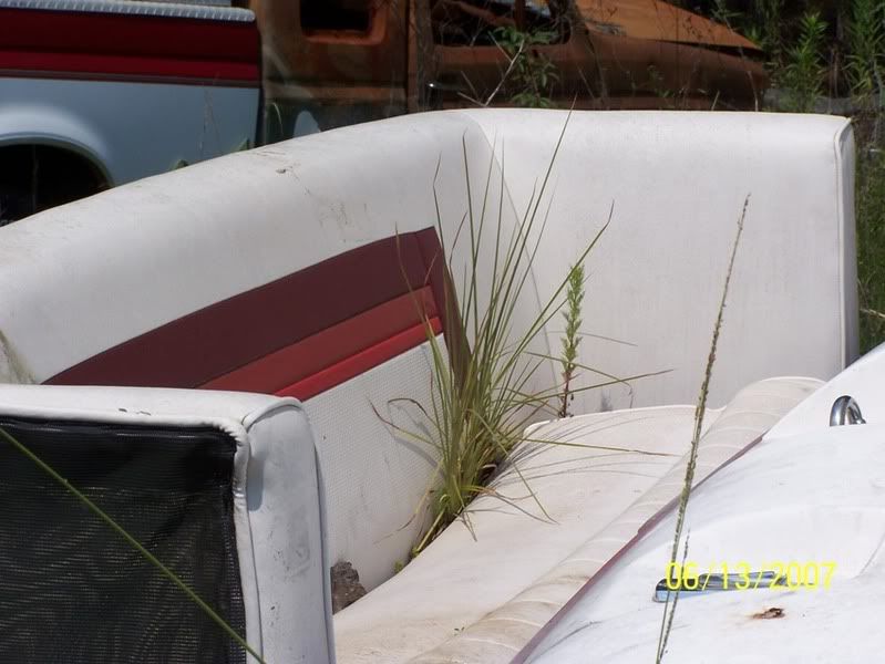

        Pulled all the interior out and cleaned up the carpets and let it air out for almost a month... The smell was astounding !!!!! Used a pressure washer and alot of elbow to get the interior and carpet cleaned.

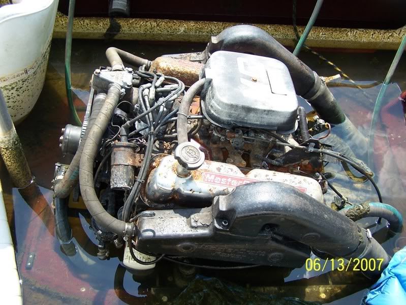

        The engine is basically a new engine... it has 360 hours on it. I know the boat and the previous owner so I know that for many years it was taken care of. Just in the last years their kids grew up and moved away so there was no need for the boat that much.
        Had been working on getting the starter replaced and the alternator and of course all of the "major" parts to get the motor checked out to see if it would even turn over. After 6 months of really just tinkering with it I did get it to turn over. Had to get a new ignition switch and WOW it was really good to actually see the engine turning over. Had to replace most hoses and the blower and pulled as many parts to get cleaned as I could. I have replaced plugs, cap, rotor, wires, and gotten as much of the rusty items gone as I could find. I have owned 4 other Mastercraft boats (1985 S&S, 2 1988 190's, and a 1990) and actually going through this rebuild has made me really appreciate this boat above and beyond the others for sure. I guess you can say this is by far my favorite boat.

          I can't believe the plug was left in....Other than the rust on the engine, I would have expected much worse. The carpet and upholstery really don't look that bad. Does she turn over? I'm really curious about that engine.

                  You have to believe that the trans is full of water. There is an air vent on top of the trans case which was fully submerged for apparantly a long time.
                  • #10
                    Actually there wasn't water in the trans ?? I have already gone through the whole boat at this point and the boat is running. I put it in the water this past weekend to check it out and it runs like a new boat. I have had to do alot of fixing and repairing and rebuilding and replacing but it runs just fine. When I got it all put back together about the only problem I had was adjusting the carberator and the smell of the carbon that had built up on the pistons.... ran it for almost 9 hours and there was ALOT of smoke at first and I have changed the oil 6 times to make sure there was no junk in the oil but so good so far. Have pulled several skiers also and no ill effects on the engine or the trans so far !!!

                      Maybe the picture does not show it that good but how on earth does that dash look that good after being out it the weather that long. Specifically the trim bezel around the switches?
                      • #12
                        Well the bezels were both in decent shape other than some slight cracking and all of the switches were good except for the blower switch and the bilge switch, those both had to be replaced. Believe it or not the carpet was salvagable..... alot of clorox bleach (diluted) and some jomax to kill the mold and mildew worked wonders. I will have more pics soon of the interior and the boat in the water finally.
