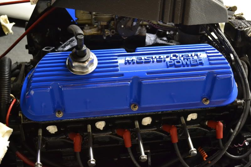

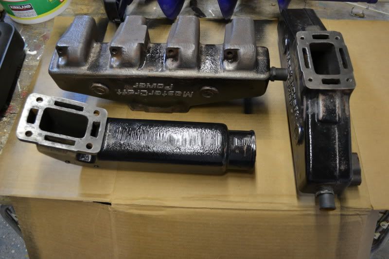

  • Powdercoated valve covers, new valve cover studs, SS nuts, SS washers, new gasket's and will have manifold's redone to new.
    PICS:

    • Nice work man.

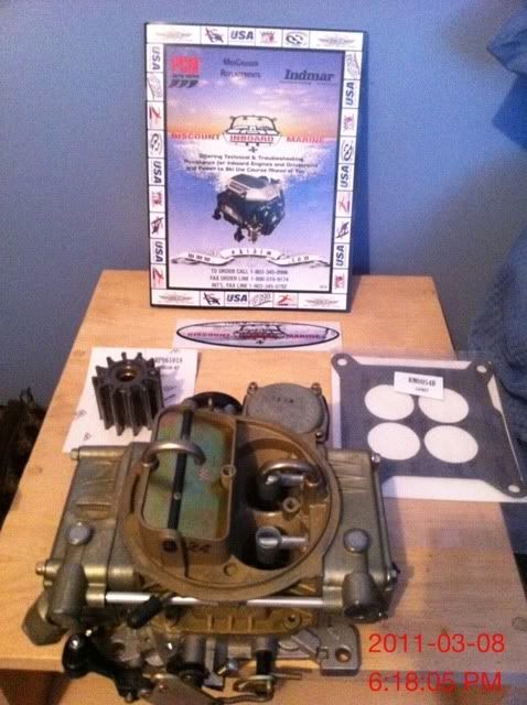

      • Didn't really work on my MC but i did receive a package from Skidim today. My 4160 carb, gasket spacer, R/W pump impeller, catalog and decal. Took 8 day to get shipped up here. Was expecting two weeks or more. Total cost was around $510.00.

          You'll be happy with that new 4160. Bought a new one for my '87 years ago (tired of messing with the old one). About a 1/2 turn on the idle screw and it was dialed in. Enjoy!

            Did you adjust them with a vacuum gauge hooked up?

                  The ones that skidim sells are already setup for the the 351. While using a vacuum gauge is probably the preferred practice for those who know how to use one, I can attest, as someone who wouldn't have a clue how to do that or what to look for if I did, that those carbs from skidim are (or at least seem to be) bolt on, adjust the idle, and go solutions.

                    Good point. Much easier to do the wrong thing with a carb if you are not well versed in tuning them than the right thing.

                          It wasn't very far off, but it did make some difference. They are pretty spot on but I think each engine is a little different it never hurts to tune. If you are having part throttle or off idle stumbling you might want to check and set the idle screw mixture.
                          I did do a high RPM plug test and they do seem to be jetted correctly for the 285/351.
                          That carb was probably the single best upgrade I did for that boat. No more difficult cold starts, crappy idle, dying or needing to rev it to stay running when cold.

                            Now that I think about it, I can't remember if I ever adjusted the mixture or not. I know I read up on it, but I think I left well enough alone. Now, I definitely adjusted the idle because it was stumbling at 400 rpm out of the box. Great upgrade for sure. I'm sure with the proper know how, I could have tweaked it to perfection. But, without that know how, the aint broke don't fix it attitude probably served me better.

                              No....vacuum gauge = beyond my tool/skill level. I just bolted on the new carb and gasket, tightened it down without a torque wrench, and it fired right up and ran great. On the water I made a minor idle adjustment to get 600rpm in gear, and that was it.

                                If you are not having off idle throttle issue then they are probably pretty close.
                                In a nutshell, You're trying to gain the highest manifold vacuum at operating temp and normal idle speed. Adjust one side a time closing them by half a turn. If the vacuum goes up do the other side a half turn. If vacuum goes down go out a half turn checking each side and always resetting idle if it goes up or down. Both sides should be set to the same setting.
