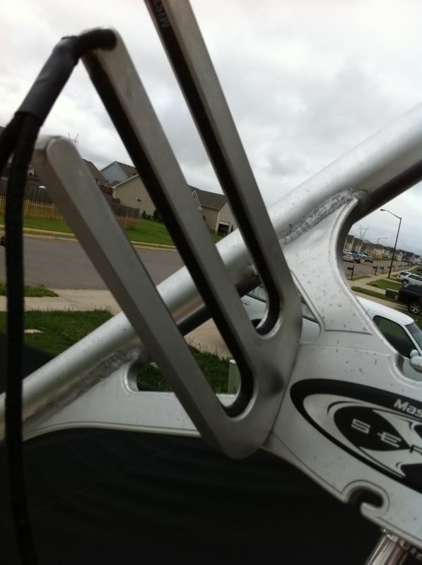

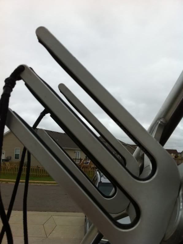

    Post up the pics!! What did you replace it with? What fingers do you have? What surfboard do you have?
    This is how it turned out. My surfer is a Obrien Aliat TT.

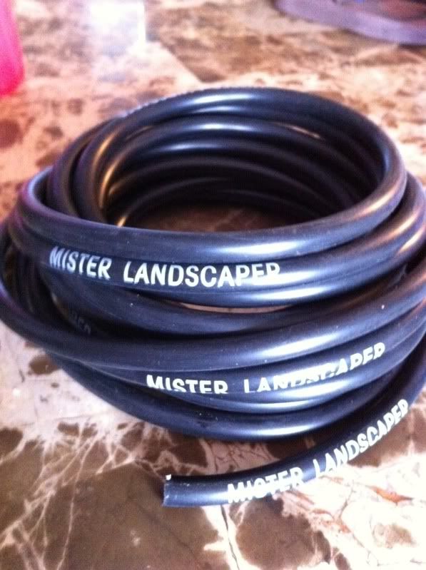

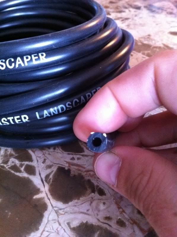

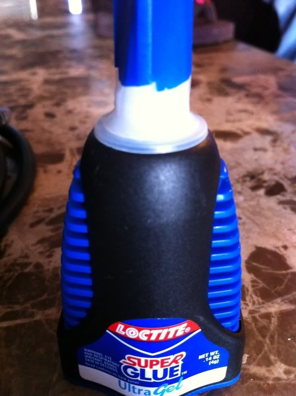

      • This is what I used. The rubber is a product called Mister Landscaper. It's hollow core rubber. Cost about $5 at Lowes for 30 feet. I like it alot better since it's not so stiff as the OEM rubber. It allows my surfer room to fit in the fingers. I tried a lot of different glues and this was the best one. Down side is that one tube will only do 2 strips. But it's strong and dries in seconds.
