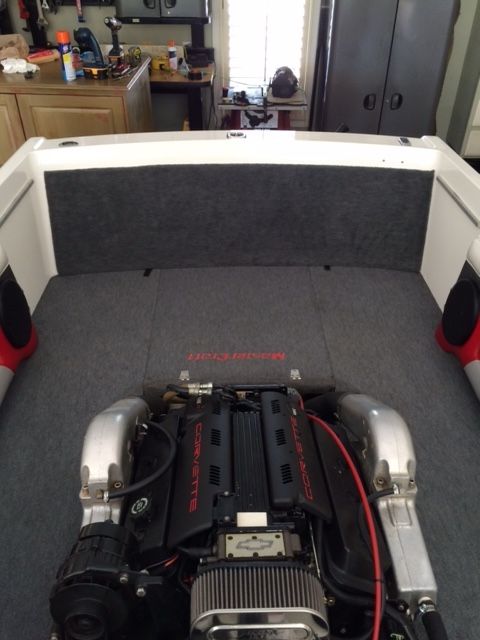

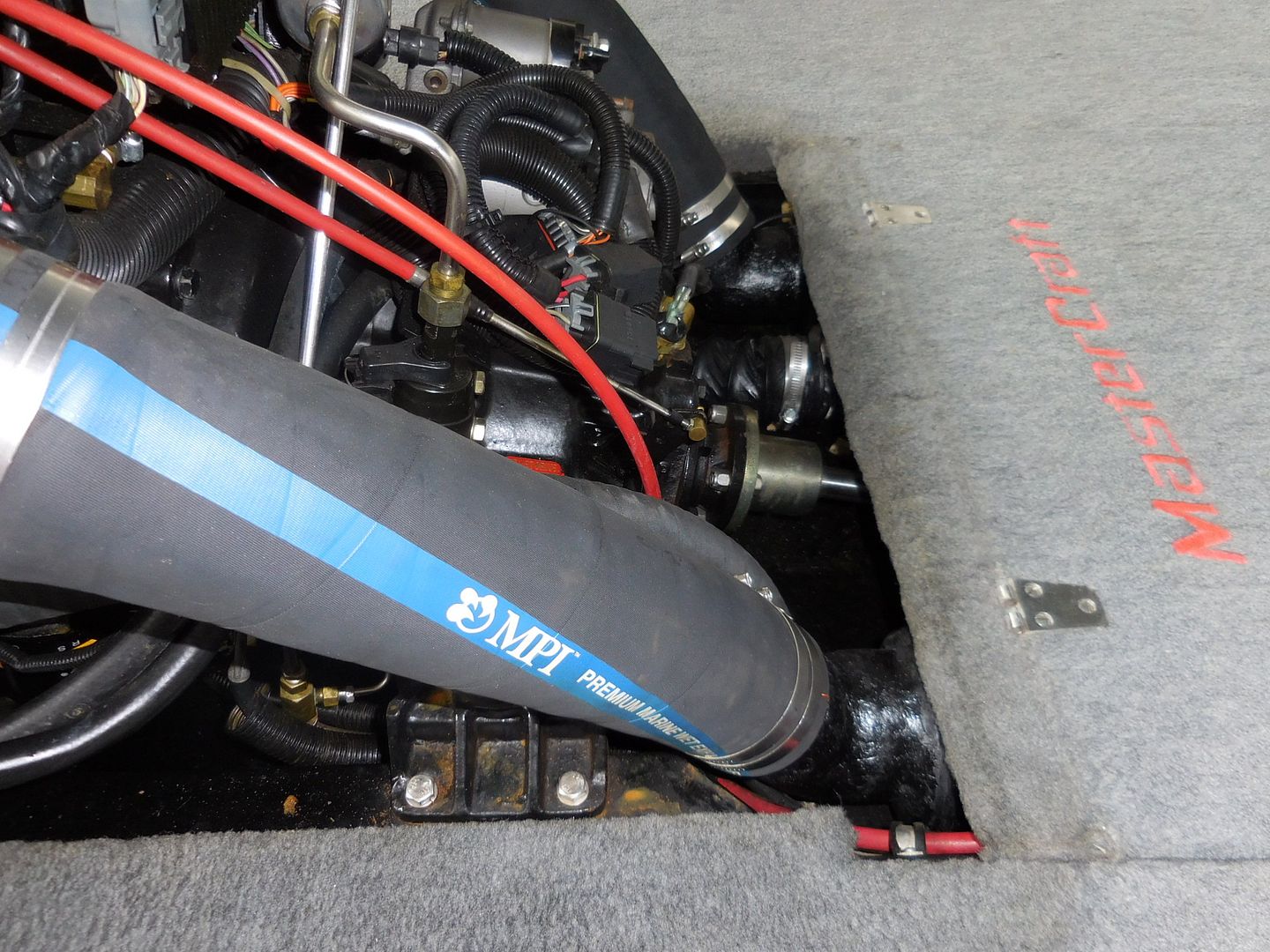

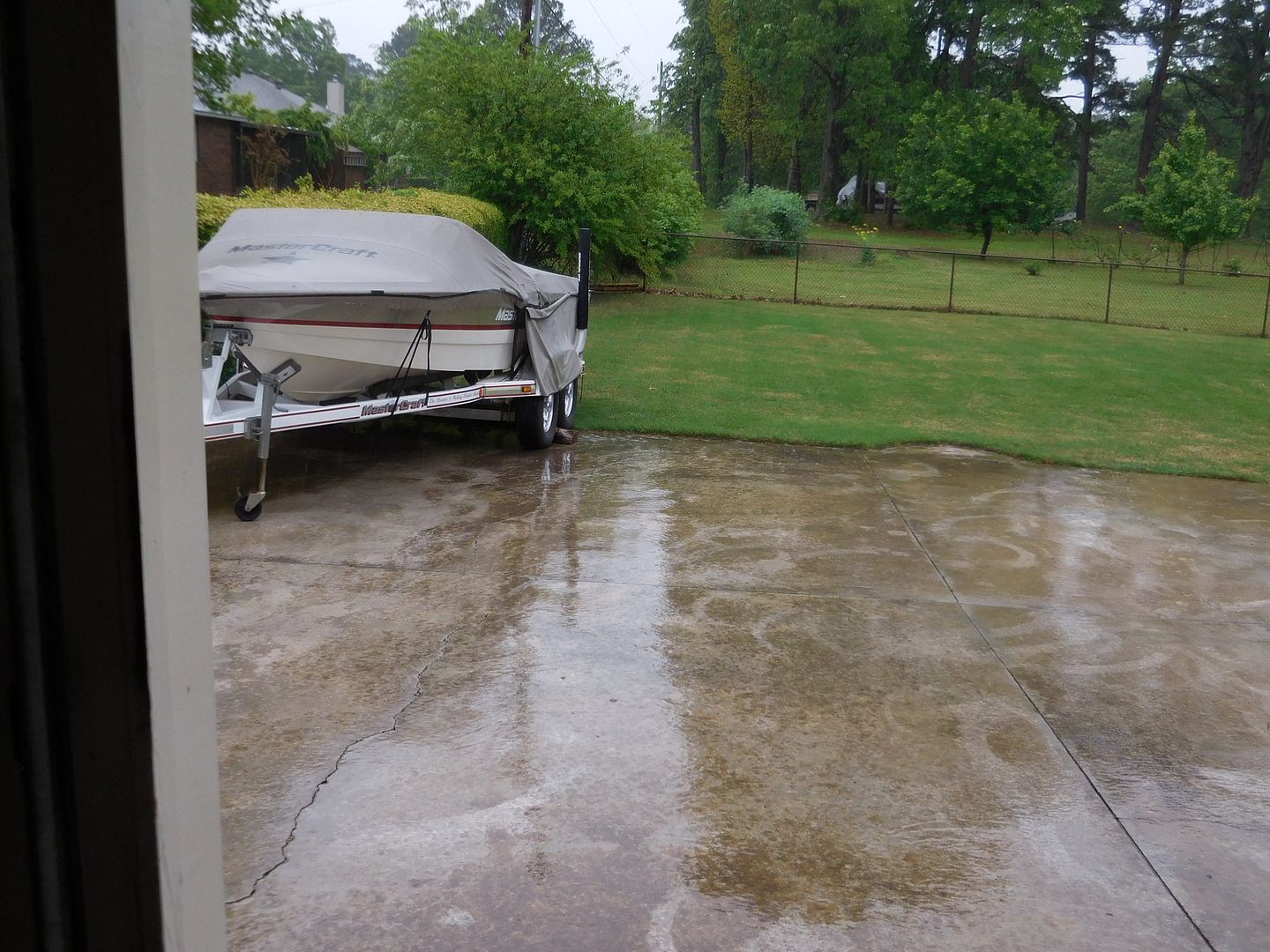

          • Got the straight pipes out, new mufflers installed, and then got rain
            • That should quiet things down.
              I love your boat. That is my favorite MC. Does that have the LT1?
              • Originally posted by Baron View Post
                yes, thank you.

                • Originally posted by BigGixxerFixxer View Post
                  Couple of questions if you don't mind:
                  Do you need to remove the risers and/or hoses to pull the mufflers?
                  Are the exhaust hoses soft wall or wire reinforced between the risers and mufflers?
                  Looking at a similar project and will probably replace the exhaust hoses while I'm at it. They appear to be the originals from 1996.
                  Thanks
                  Yes risers have to come off.. hoses are wire rei forced
                  Sent from my SM-G955U using Tapatalk
                  sigpic...A bad day water skiing still beats a good day at work...1995 Pro Star 205....
                  • Mike, mine were soft wall (old and new) so I was able to bend the new hose today. I put just a tiny bit of grease on the one new muffler end to back exhaust hose and then slightly greased the new hose on both ends - took about 20 minutes for install. Now, the final fit and tighten took another 15-20 but put some rubber pad under both mufflers, made sure floor was a good fit. I did manage to get a water check before the rain but my engine cover was at home; got it in and attached and the clouds opened up!
