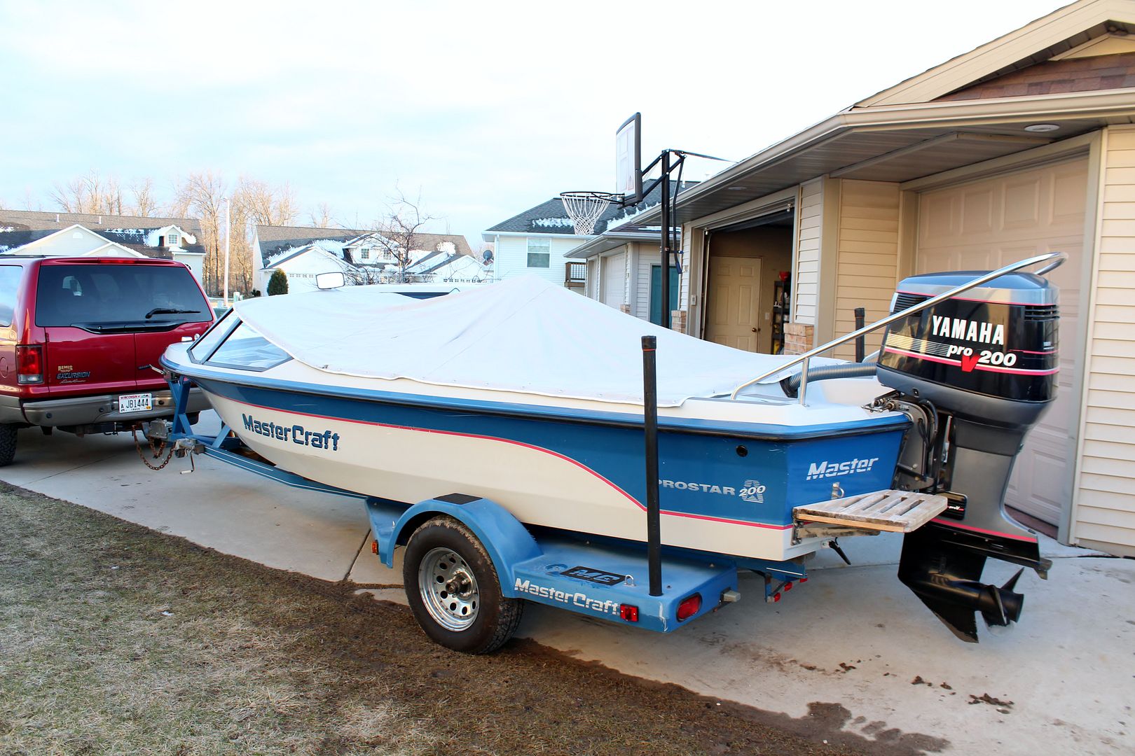

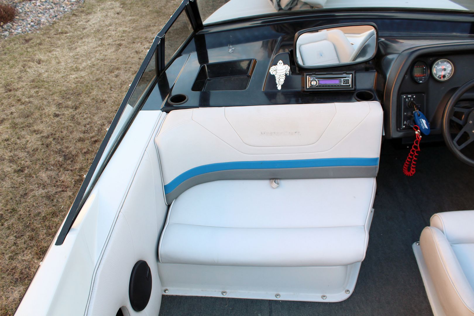

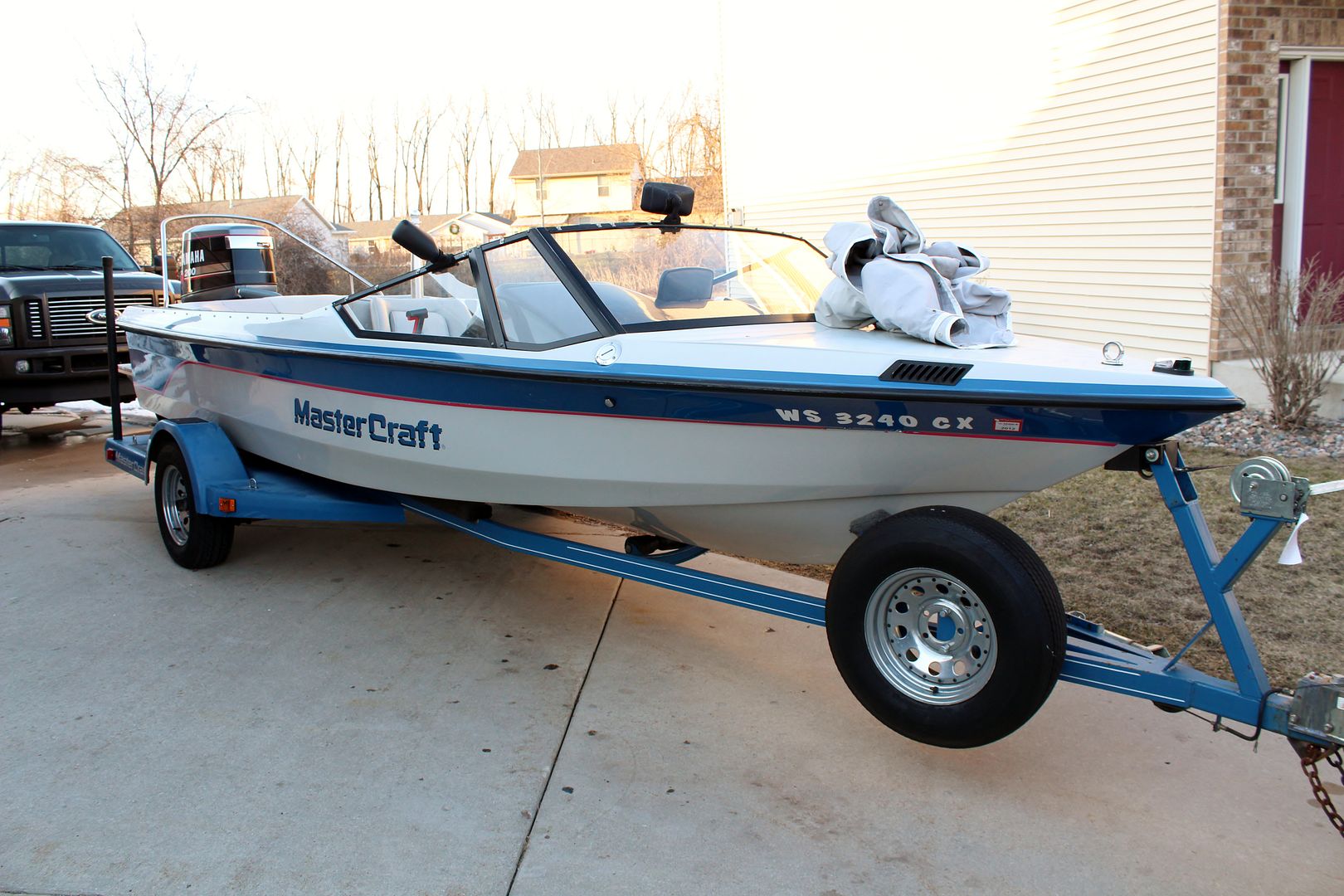

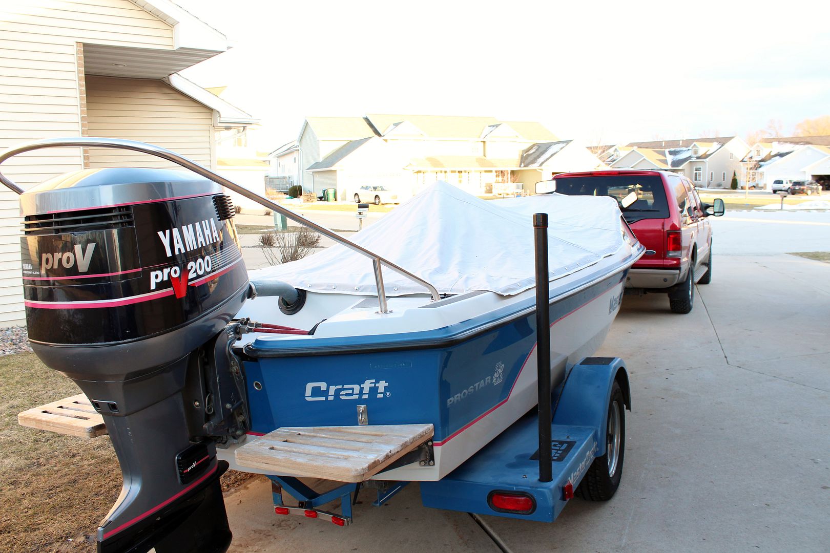

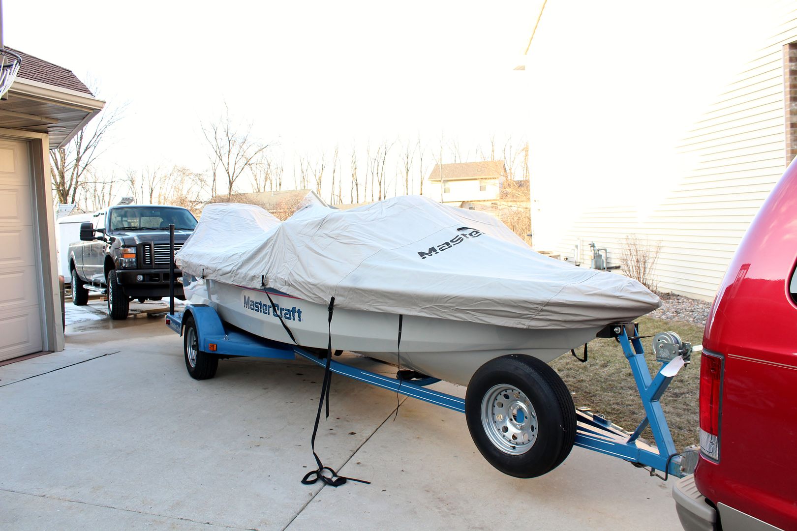

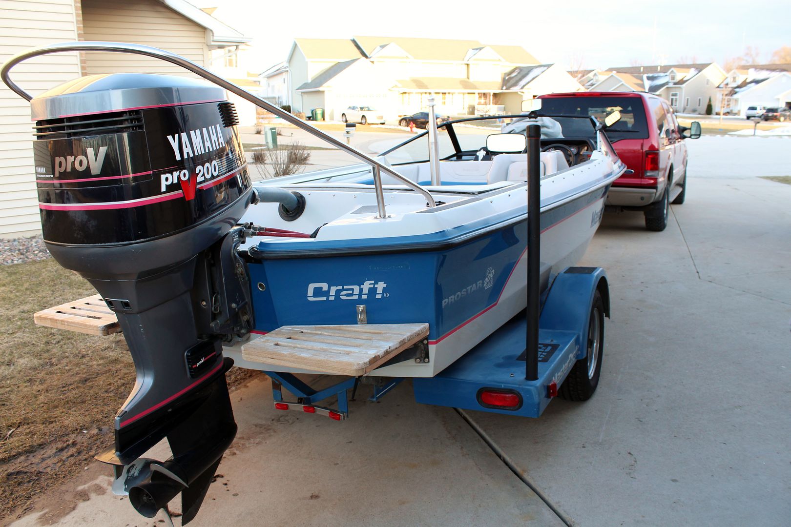

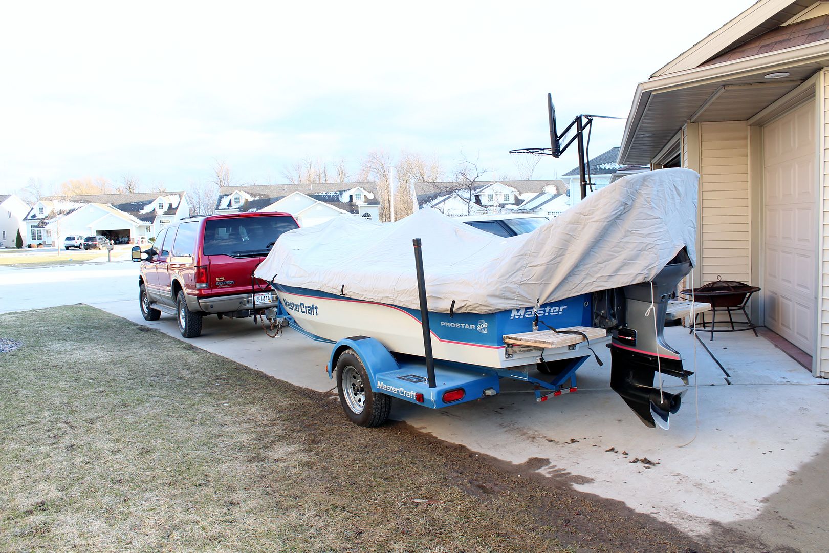

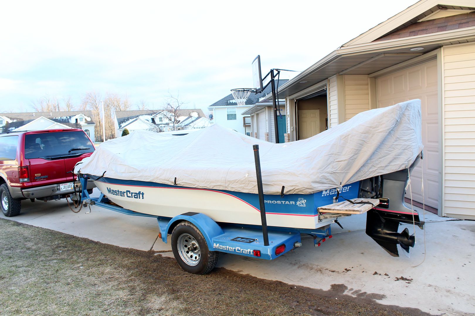

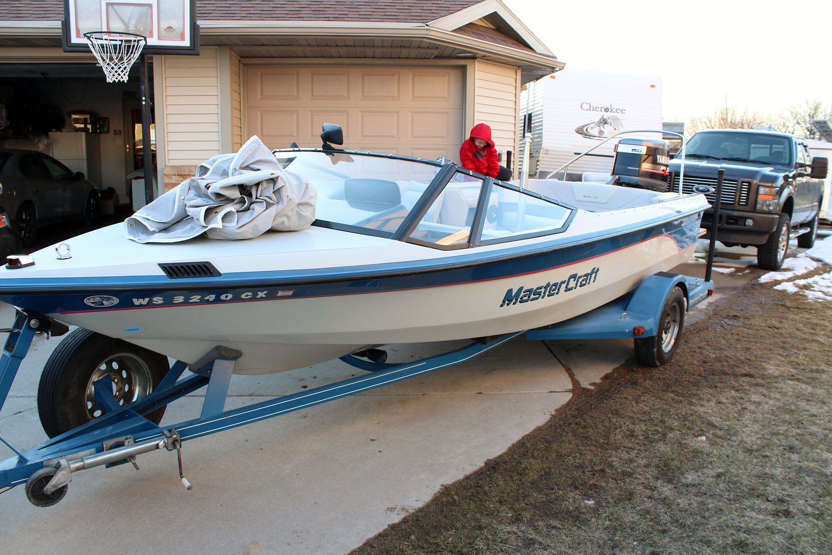

    Found this 1991 ProStar 200 Locally on Craigslist. They where asking $7500 got it for $6900. It looks like it was taken care of cosmetically but neglected as far as cleaning and waxing stand point. Came with **** pit cover and full trailer cover. There is not much dock rash and know gelcoat chips. Here is what the boat looks like when I picked it up.
    1991 ProStar 200

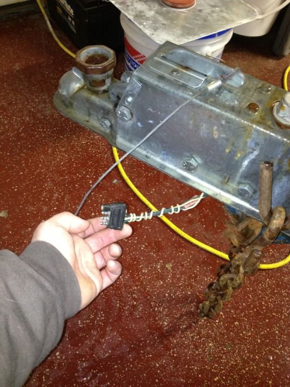

    Lengthened trail plug the car wire because it was only sticking out from under the tongue six inches.

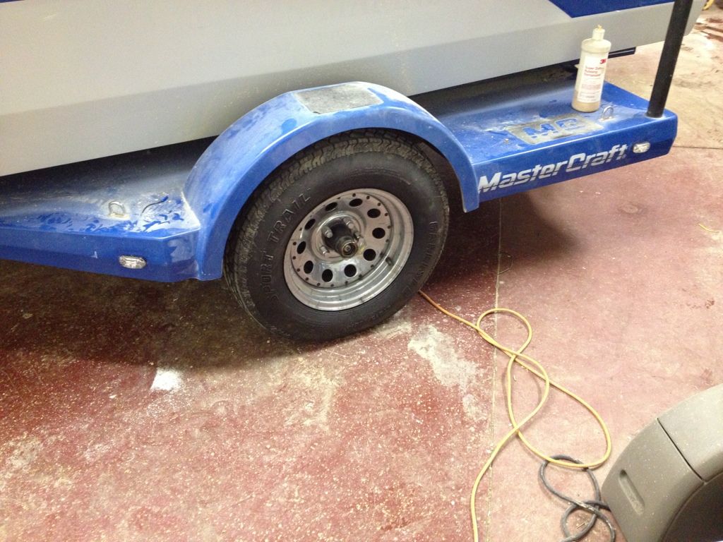

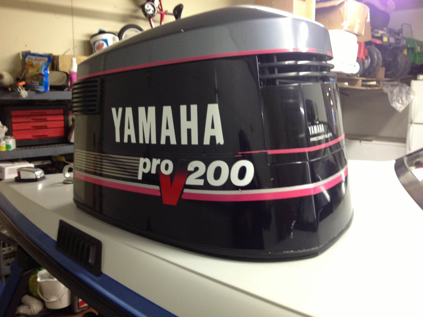

    Stripped all the pin stripping from the boat and motor so I can sand and buff the whole boat because it is all faded.

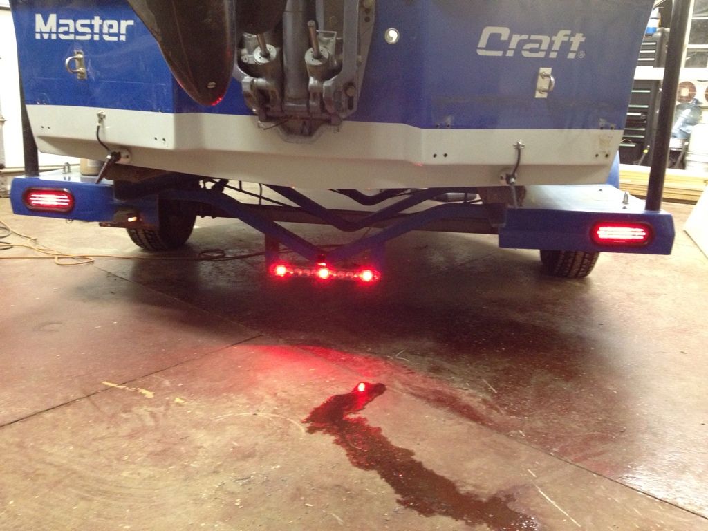

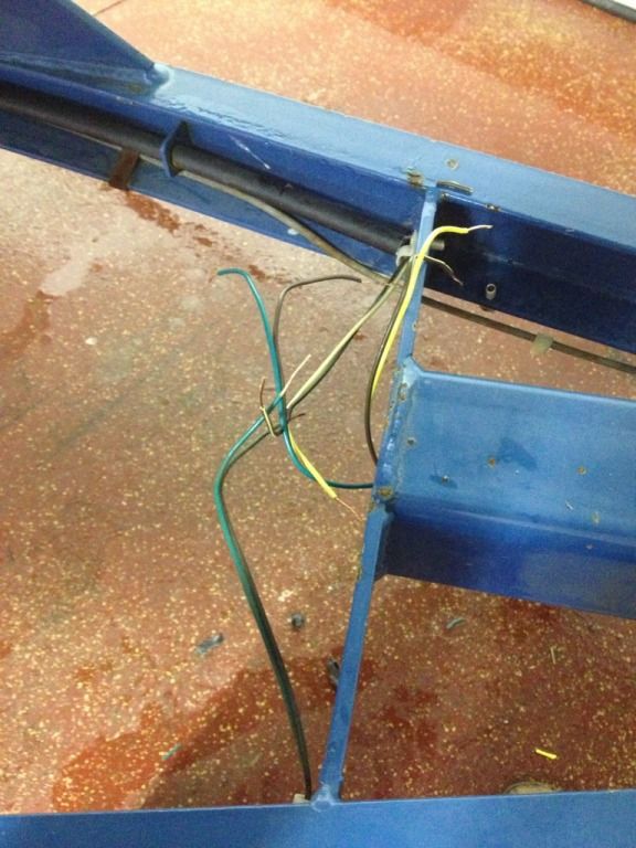

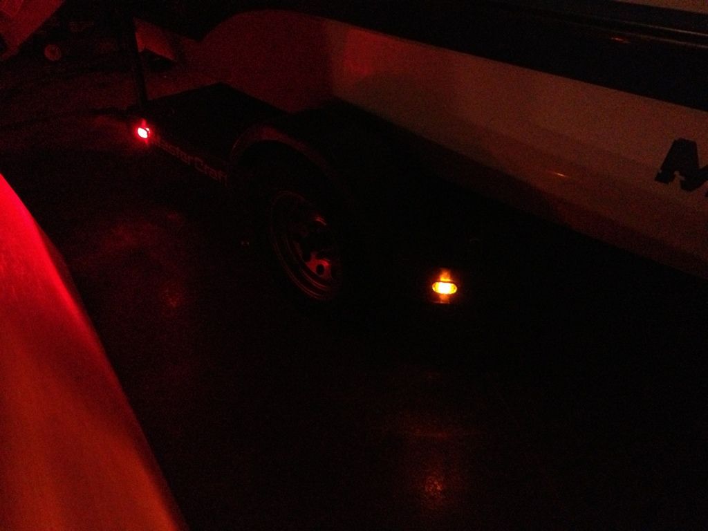

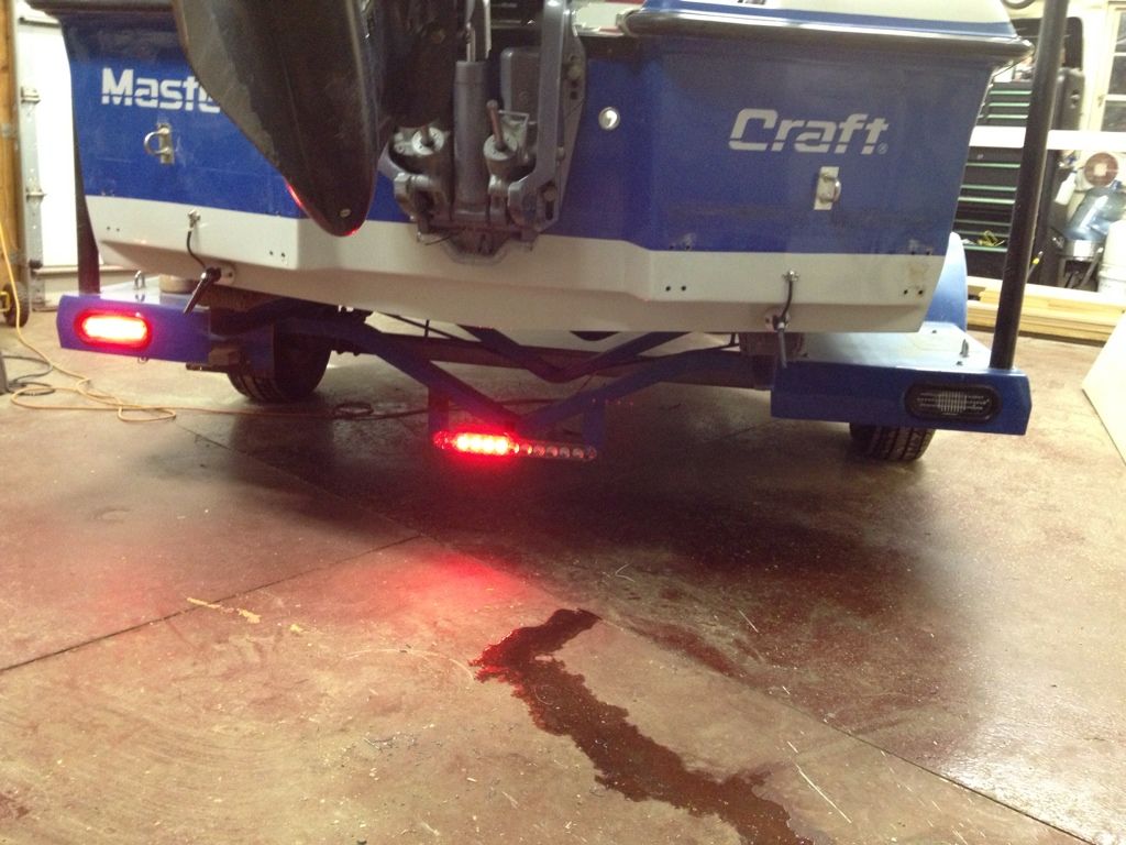

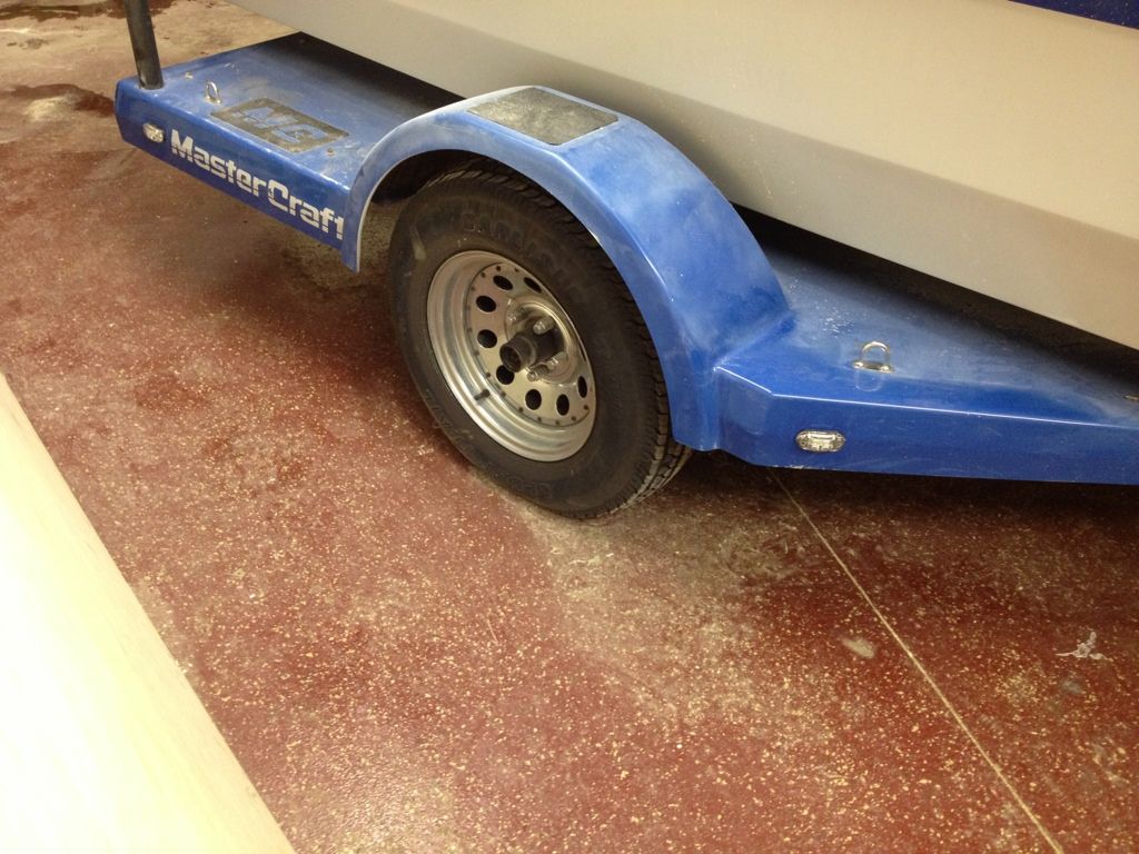

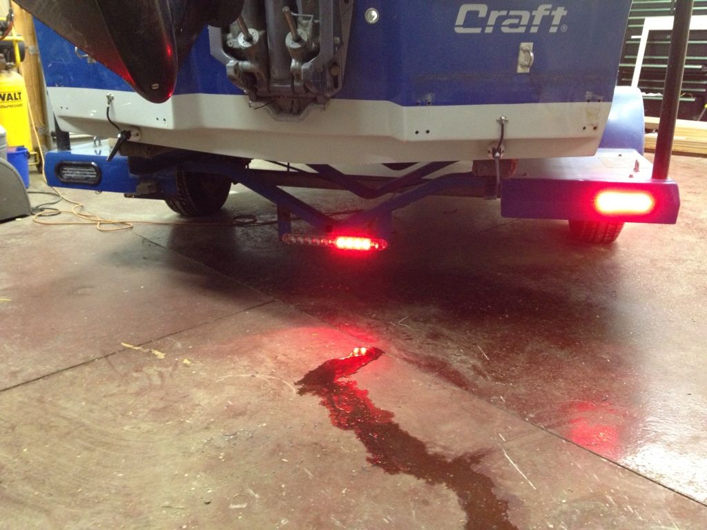

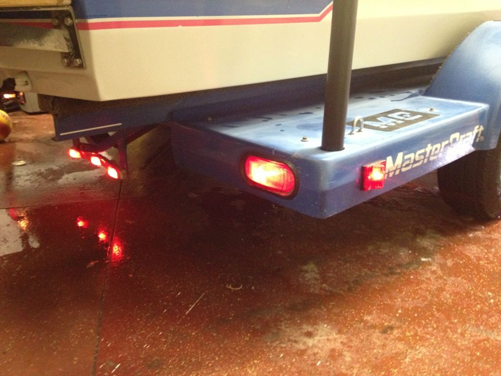

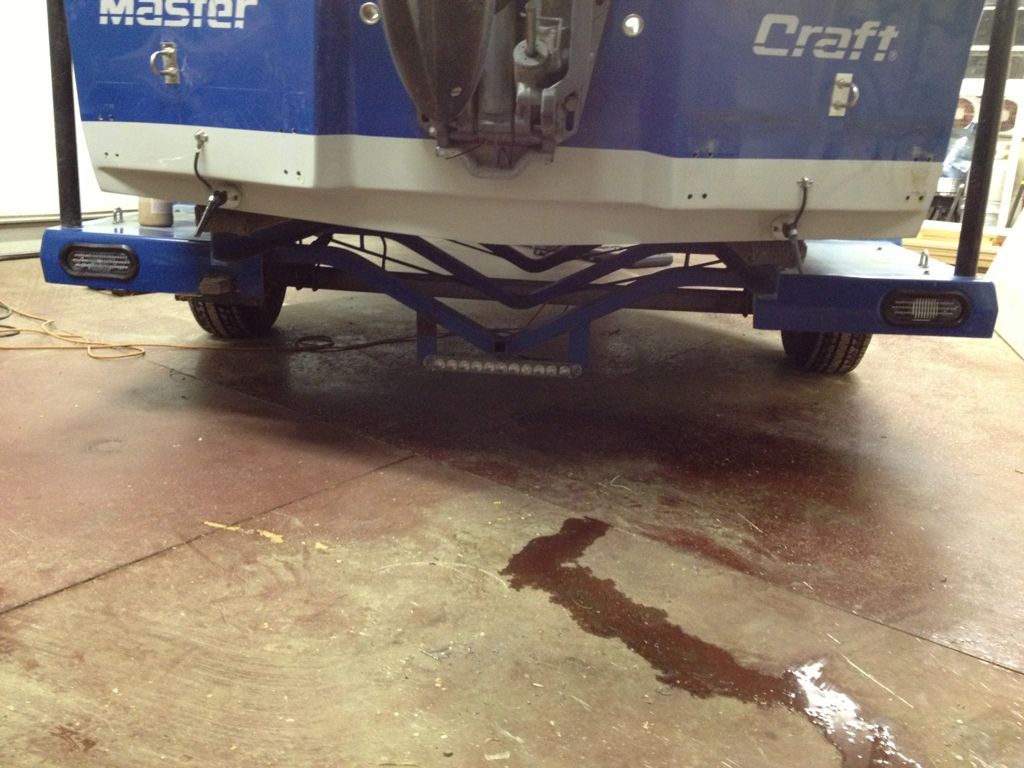

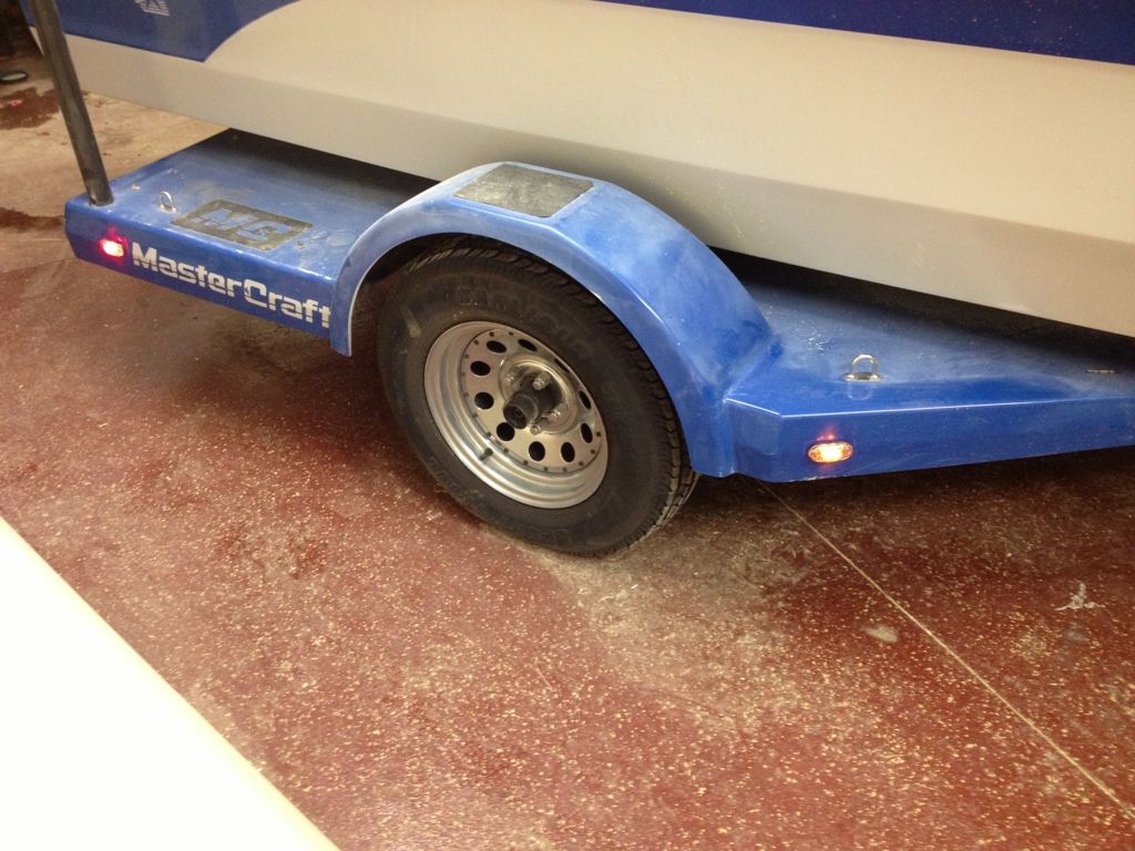

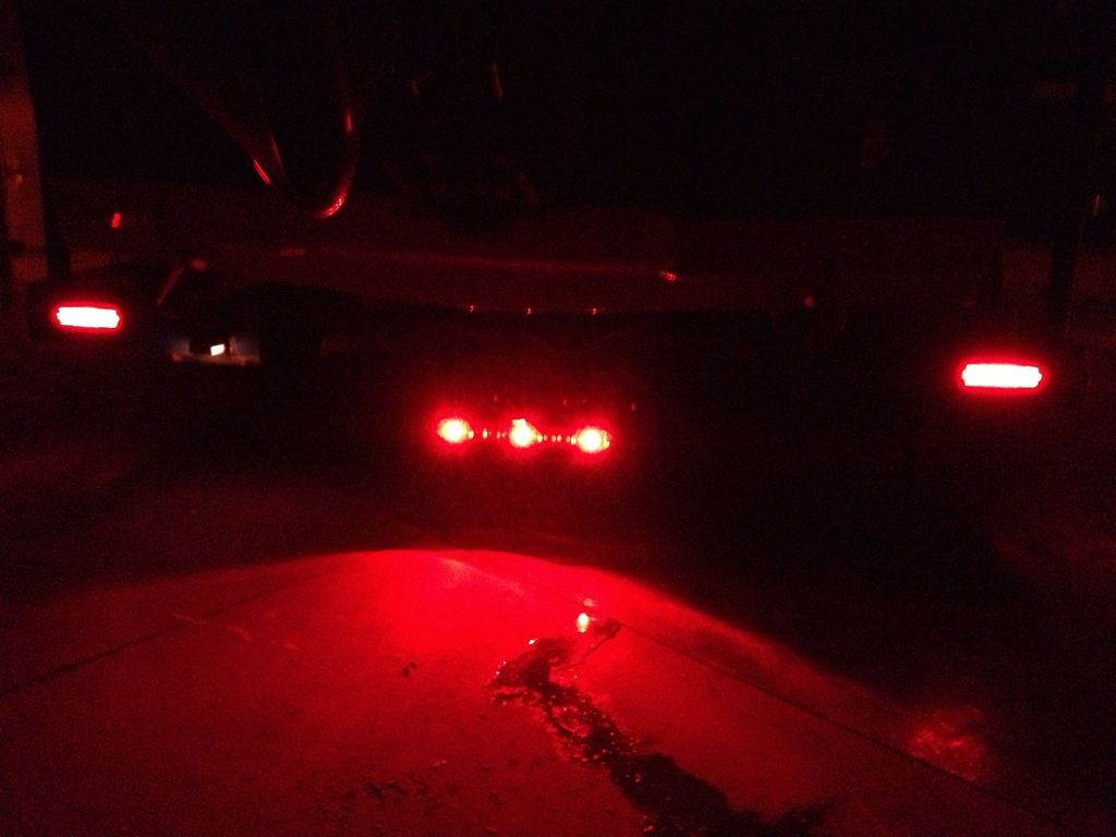

        Bought all new clear LED lights for the trailer. Buffed the sides of the fenders out before I put lights in. Had to rewire the center light because it has a running light, brake light and left and right turn lights.
        Before
        Lights off
        Running Lights
        Brake Lights
        Left turn Signal
        Right turn Signal

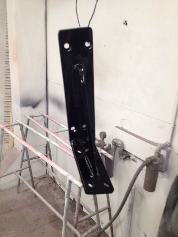

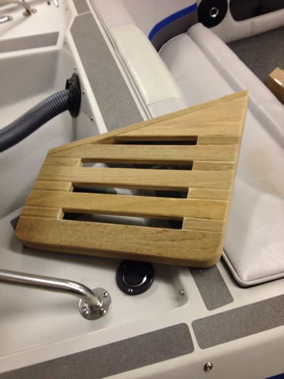

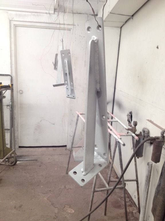

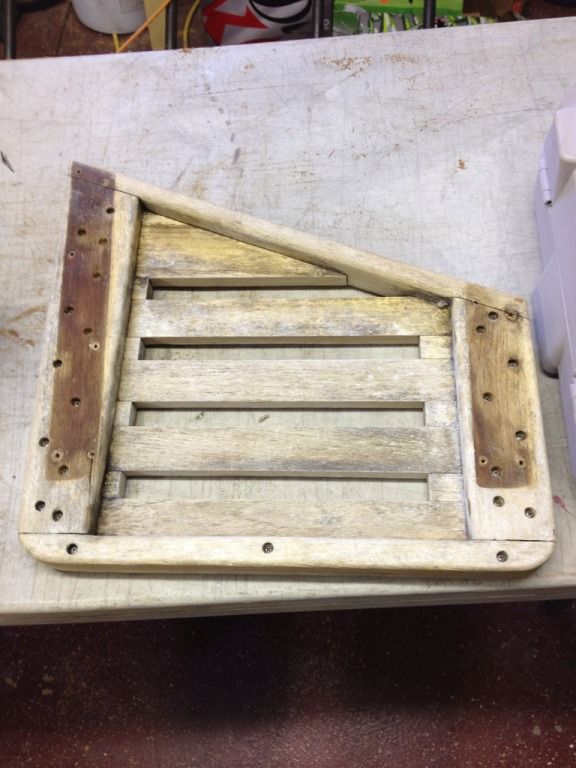

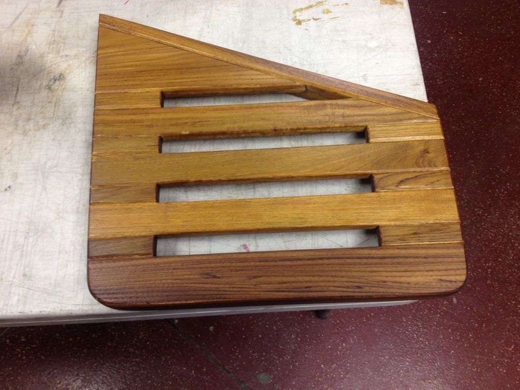

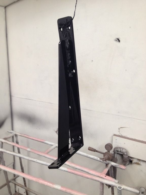

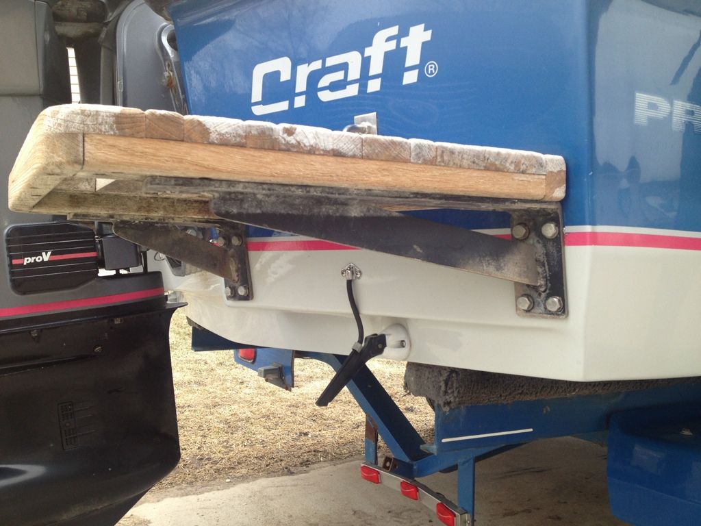

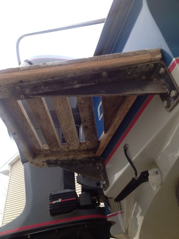

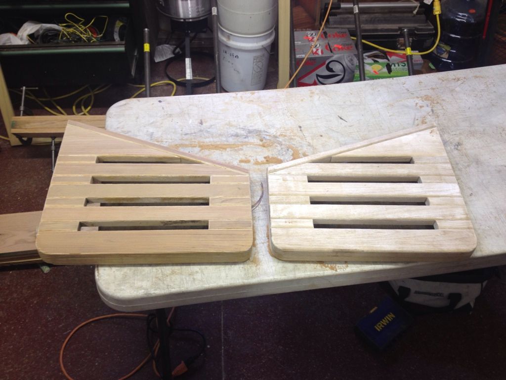

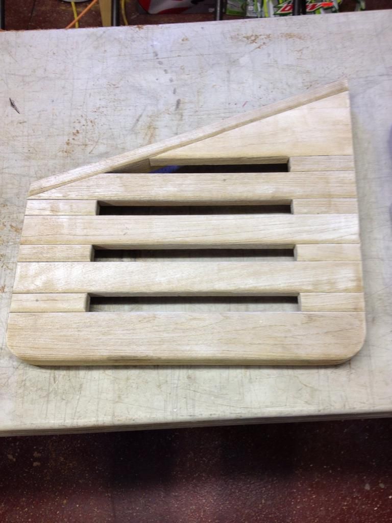

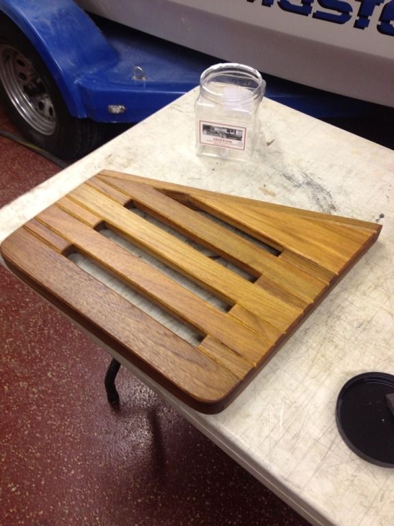

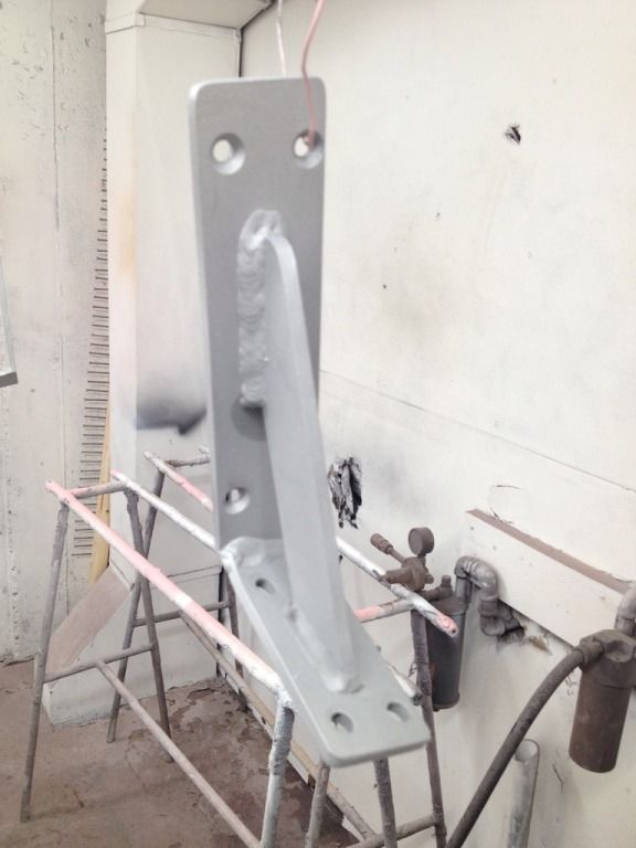

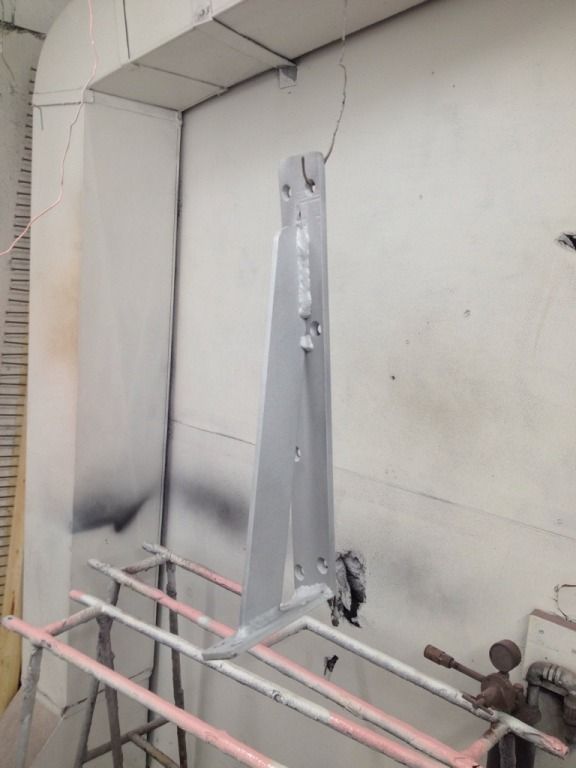

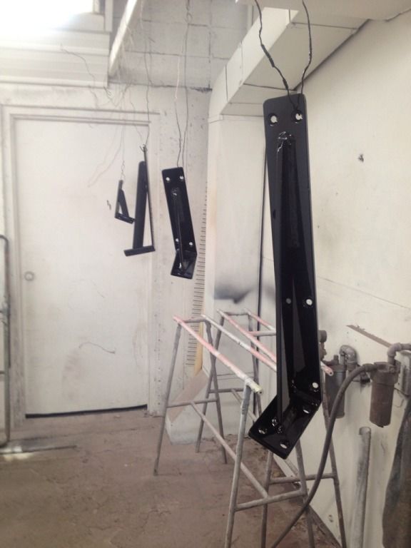

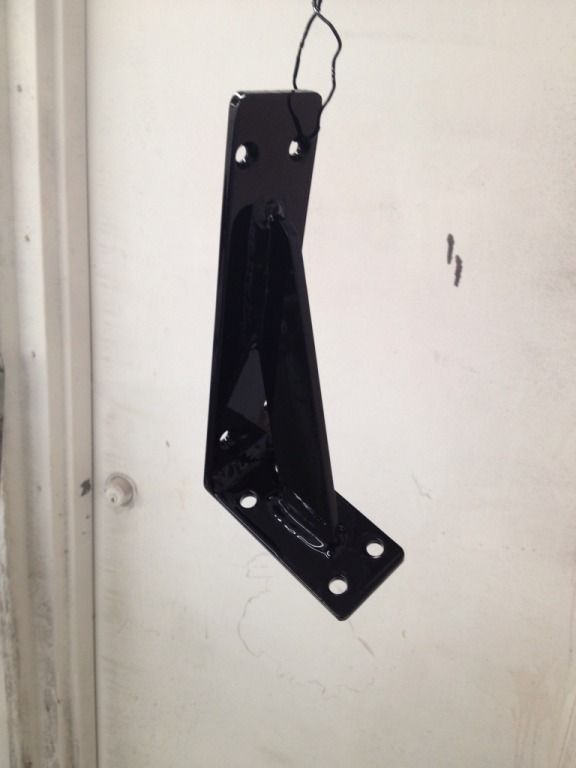

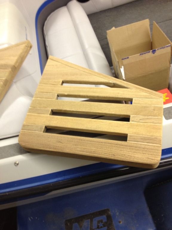

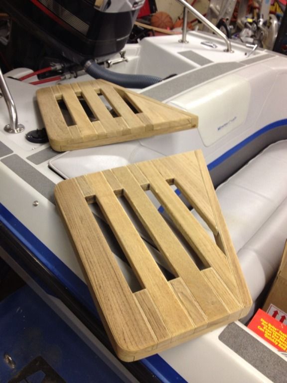

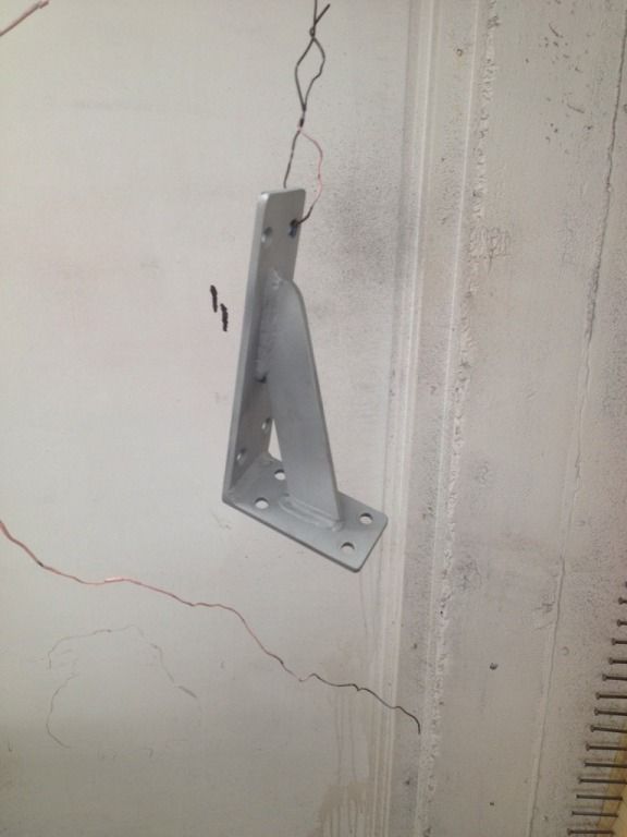

            Took the rear platforms off when I took all the pin stripping off. Decided to sand blast all the brackets and base coat cleat coat them. Also sanded up all the teak and refinished them. Just got finished with them tonight.
            Before
            Sandblasted brackets
            Painted Brackets
            Swim platforms before
            One sanded one not
            All sanded and cleaned up with starbrite
            Refinished with Starbrite Teak oil

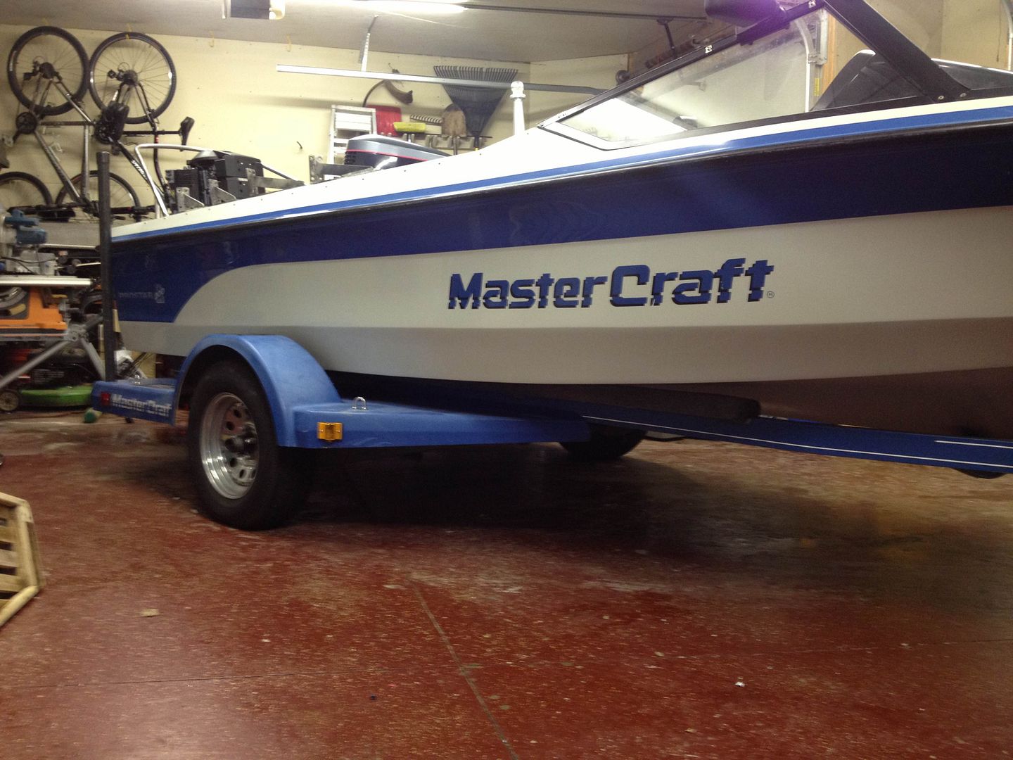

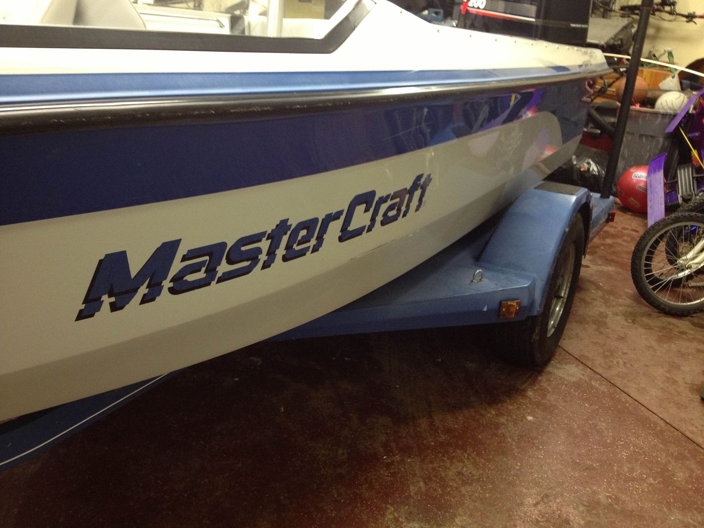

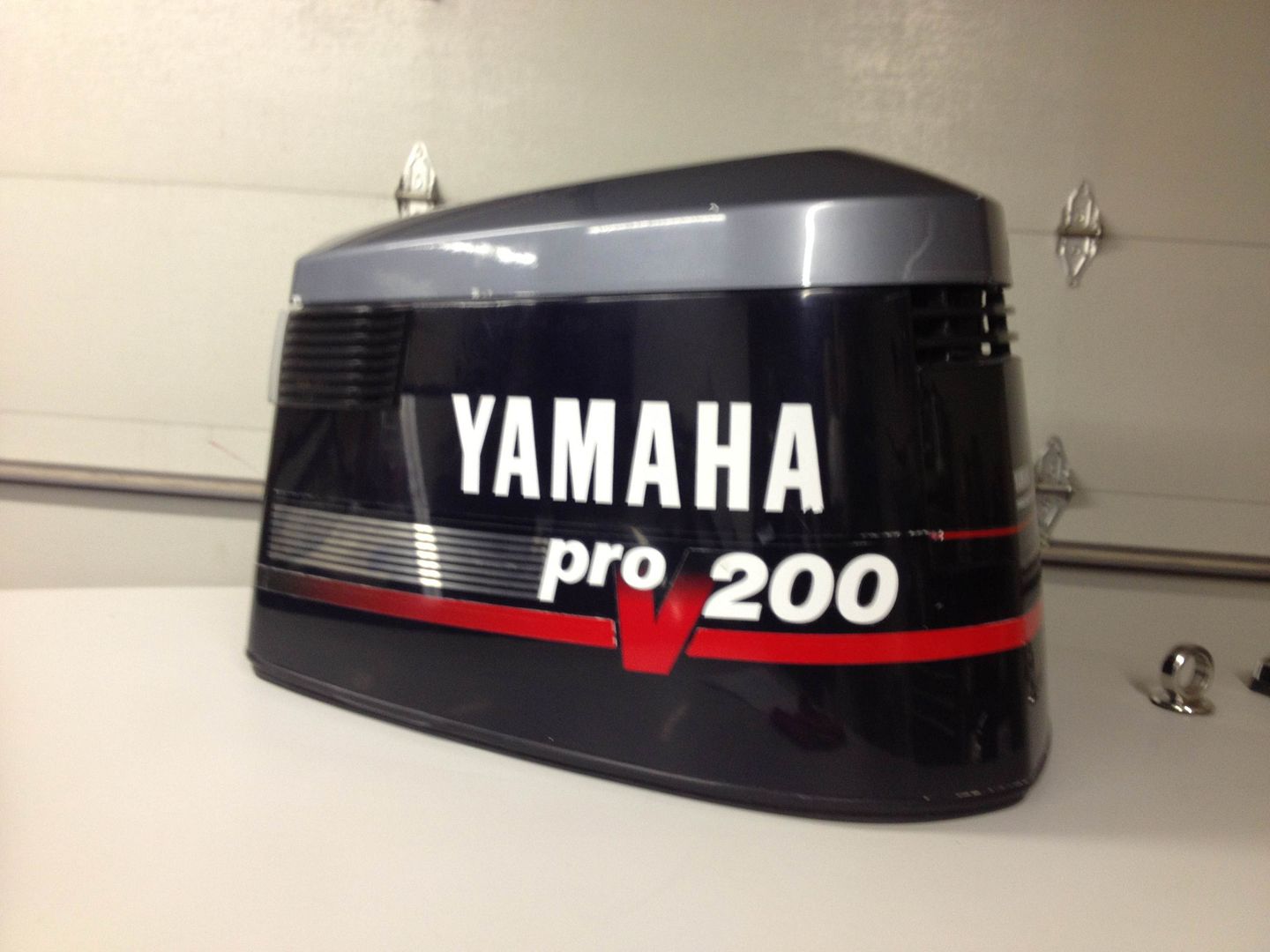

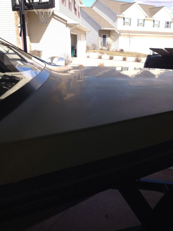

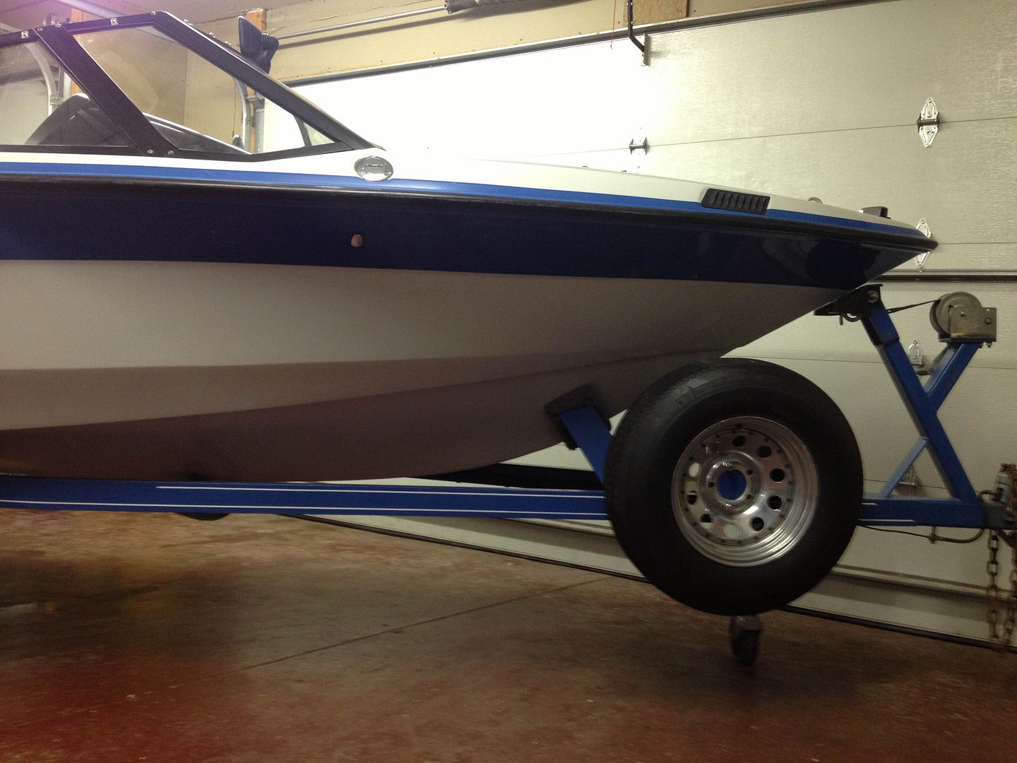

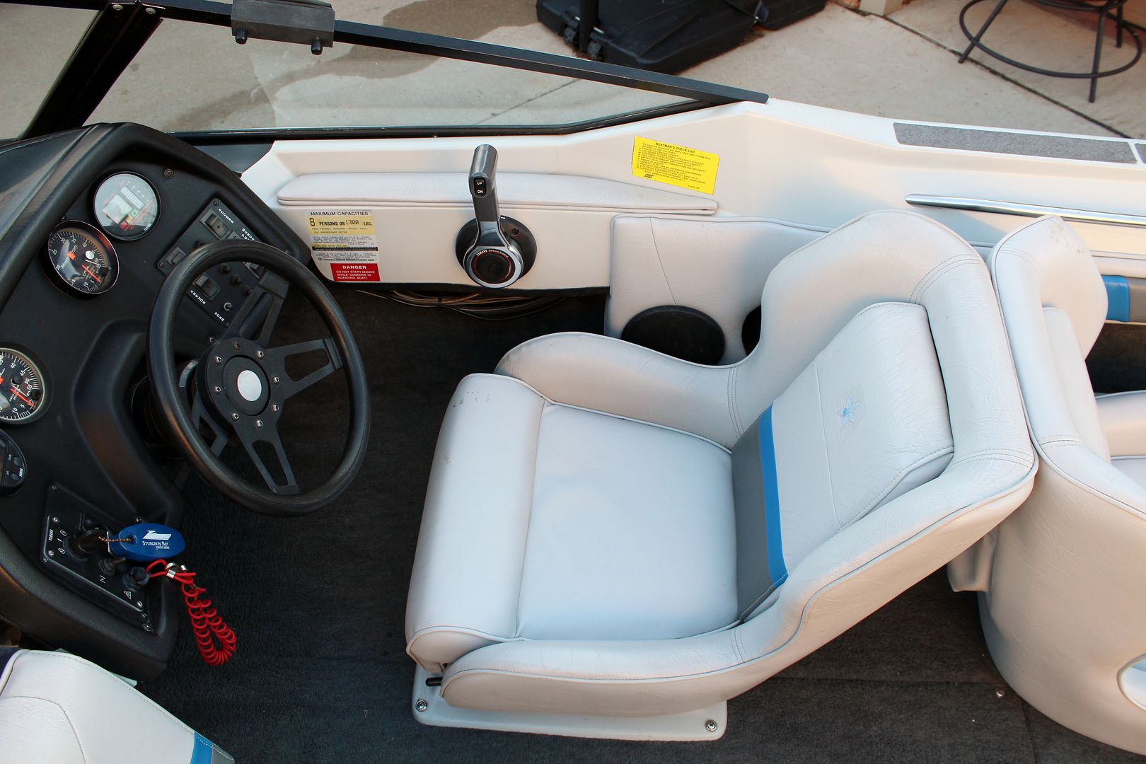

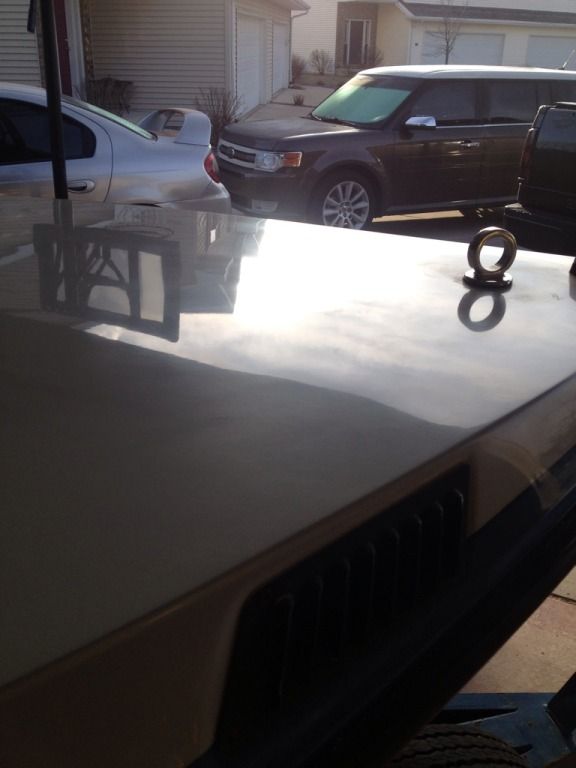

                Started to mess around with buffing the other day. Here is what I got so far.
                Faded
                Buffed

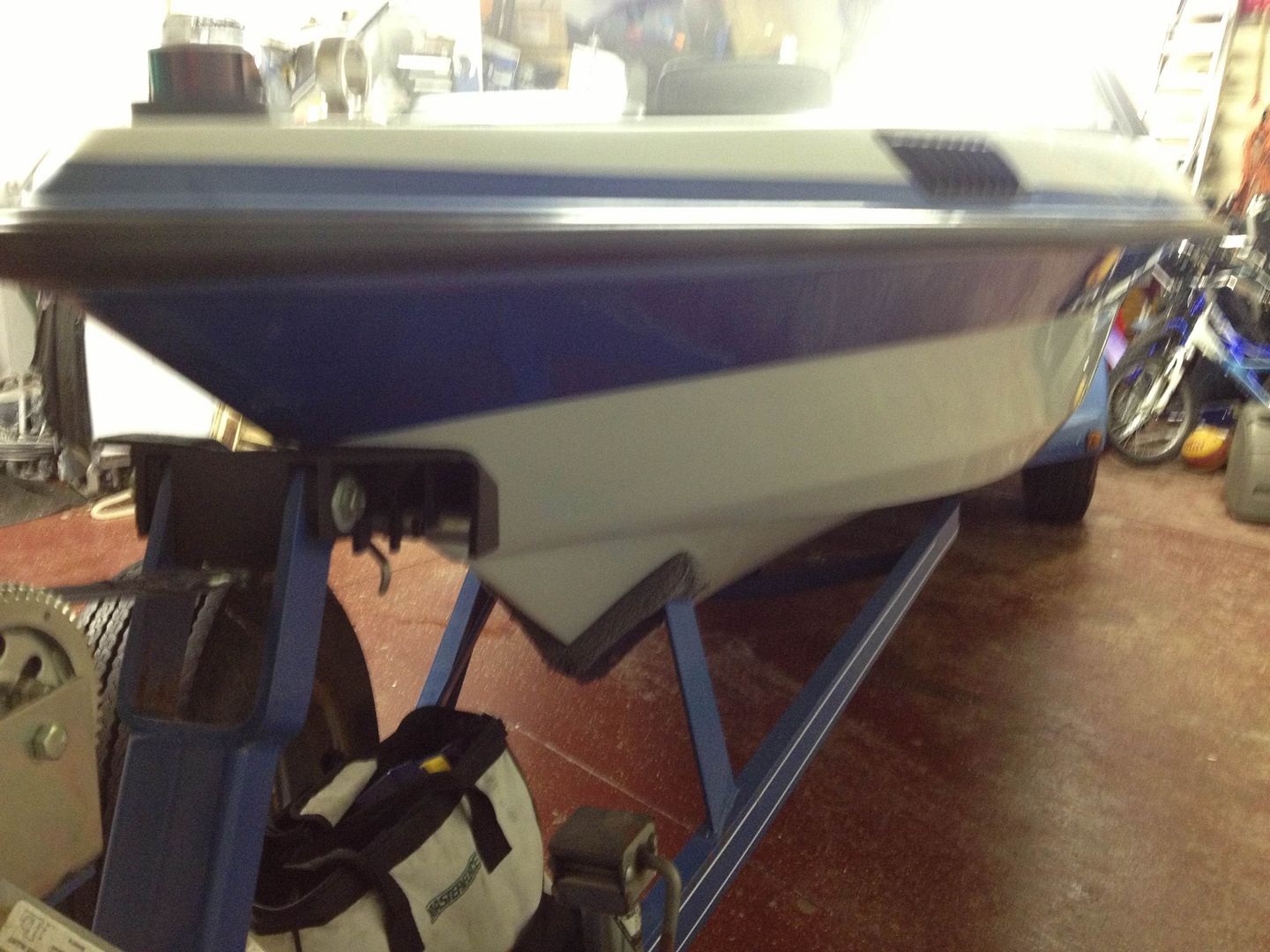

                  This is what I got done so far. Hope to do brakes next week and some more sanding and buffing.

                      Great progress! Keep it up! Boat will look new in no time!
                      I like how the brackets came out after the blasting!

                        [QUOTE=NorthCentral Customs;927723]Started to mess around with buffing the other day. Here is what I got so far.
                        Faded
                        What did you use to buff??
